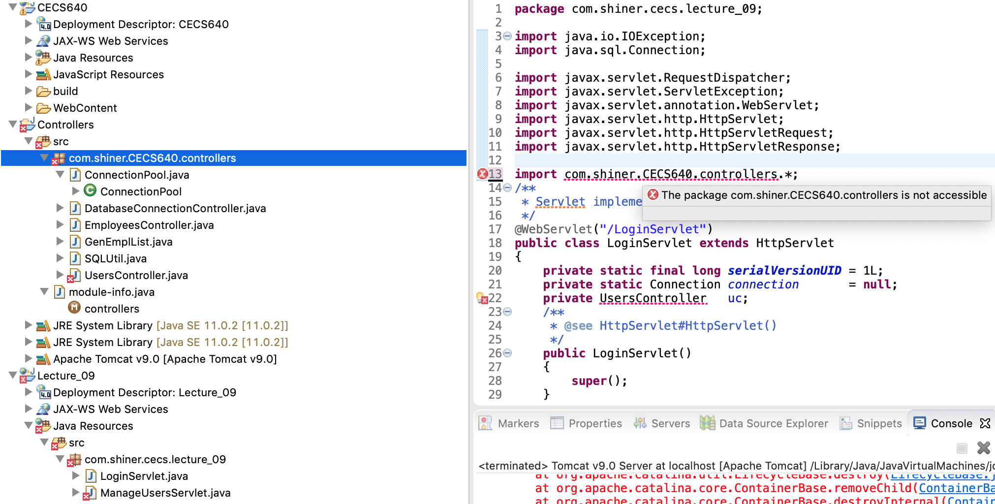

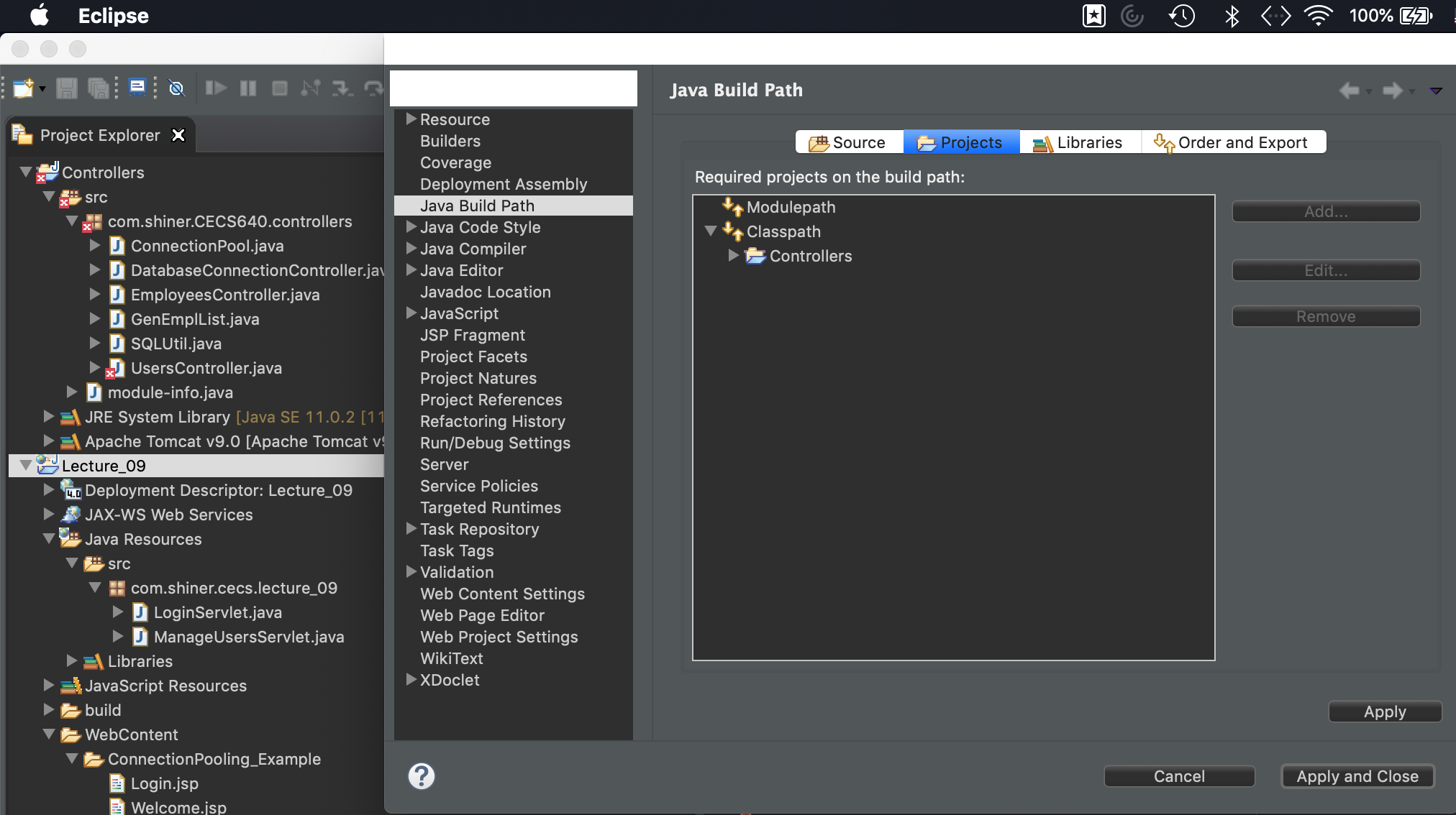

Upon trying to implement the MVC paradigm, I am having trouble access packages across projects in eclipse. Eclipse indicates that the packages in Controllers are "not accessible" in my Lecture_09 Project. I've included Controllers in the Build Path of the Lecture_09 project and I still get the same error. I've attached a screenshot of the problem I keep getting. I also get the same error if I name the controllers directly with the only difference being it says the 'type' is not accessible. I feel like I must be missing a very simple error, but I can't seem to find any solution to my problem. Any help would be appreciated.

Unless you're trying to build a modular application and failed to mention it, delete that module-info.java file.
