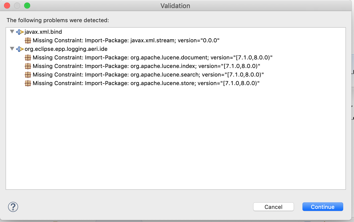

I have a brand new fresh installation of Eclipse 2018-12, and the xtext Hello World example, org.xtext.example.mydsl, does not work. Specifically, the steps that fail (on a brand new Eclipse) are these:
1. Install xtext as here: https://www.eclipse.org/Xtext/download.html
2. Create a new xtext project
3. Right click on the sample xtext code and Run As -> Generate Xtext Artifacts
4. Right click on the project and Run As -> Eclipse Application
5. In the new Eclipse, create a new project and a new file in the src directory with the right extension.
The only warning of any kind is this:
The file "plugin.xml" does not exist
Upon launching the second instance of Eclipse, creating a new project, and creating a test file foo.mydsl, all I get is a massively heavyweight plain-text editor. There is no outline and no highlighting. There are no warnings, no errors, nothing that I can find. I have to conclude that xtext simply doesn't work with Eclipse.
The 15-minute demo here fails in exactly the same way:
https://www.eclipse.org/Xtext/documentation/102_domainmodelwalkthrough.html
During installation of xtext, I get "Cannot perform operation." The only option offerred that will install the xtext IDE is "Install different version than originally requested". See attached screenshot. I tried both:
http://download.eclipse.org/modeling/tmf/xtext/updates/composite/releases/
and
http://download.eclipse.org/modeling/tmf/xtext/updates/composite/latest/
Same conflict seems to occur with both.
Suggestions? This does not make me very optimistic about using xtext with Eclipse.

the errror message you show should be unrelated.
can you go in the runtime eclipse into "host osgi console" in the console view
and type "ss mydsl" to see the state of the plugins
and "start <id>" to start them if not active and or to see error messages
