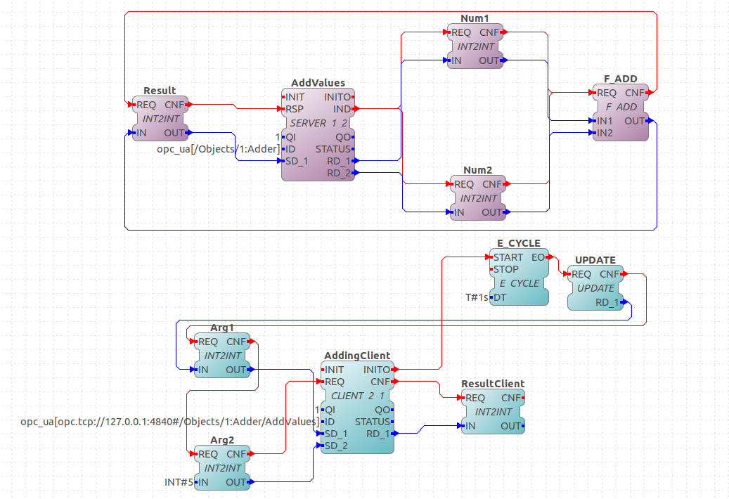

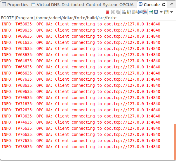

I have implemented a simple client and server by using OPCUA over TCP with port 4840. The client and server are communicating but the console gives a message of
INFO: T#448635: OPC UA: Client connecting to opc.tcp://127.0.0.1:4840
for each trigger of the client function block. can somebody guide me, how can i remove these messages or what is the actual problem.
Second, i would like to ask that is this possible to use OPCUA over UDP? If possible then what ID format should we use in function block at the place of "opc_ua[opc.tcp://127.0.0.1:4840#/Objects/1:Adder/AddValues]".
The images are attached. Your comments will be appreciated. Thanks

Hi Adeel,
As the starter of this message says it is just an Information message, which we added to help us debugging the 4diac FORTE open62541 integration. You can get rid of it by settting the loglevel to LOG_ERROR in cmake.
Currently we don't have the OPC UA Pub/Sub implementation available in 4diac FORTE. As open61541 has it now it is on our roadmap but I can not say when it will be ready.

Thanks Dear Alois for your quick response. It works.
