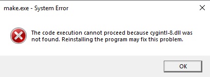

We are following the instruction line by line and now we are in the "Generate 4diac FORTE Makefiles with CMake", Step 3. When we click on Configure we get two errors as following:
"The code execution cannot proceed because cygwin1.dll was not found. Reinstalling the program may fix this problem"
and
"The code execution cannot proceed because cygintl-8.dll was not found. Reinstalling the program may fix this problem"
The errors are attached.
We tried reinstalling CMake and no luck.
We are in Windows 10, and we use MinGW. We also use forte-incubation_1.10.1 as the source code of FORTE.
We appreciate any help.
Reza

Hi Reza,
could it be that you had also some make programm from cygwin or another toolchain installed? Would you mind sending me the content of your path variable (better privately). For me it looks like there is a clash between different toolchains. The cmake setup seams to be fine.
Alois
