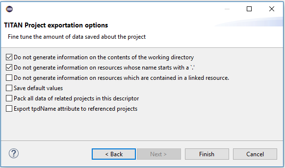

For the sake of other readers, I would suggest at generating tpd file by exporting project description via Project popup>Export...>TITAN>TITAN Project settings, after Next choose settings according to the attached file.
index.php/fa/34964/0/
