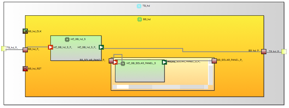

Good afternoon, we want to copy elements from one model to another model (different files in the workspace) mantaining the layout saved in the source sirius viewpoint. We are coping the model elements using EcoreUtil, and then using the functionality of drag and drop we include the element in and specific view. How can copy the model elements and copy the diagram layout from the source model too?
When we copy the model elements everything appears inside at the left top corner as shown in the attached figure.

I think you can reuse the mechanism under the extension point org.eclipse.sirius.diagram.ui.formatDataManagern that allows to provide a specific copy/paste format manager. The copy/paste format manager by default use the semantic element as key. But sometimes, it is not enough. You can find an example [1] in Capella [2].,
But in your case, you can just create a specific org.eclipse.sirius.diagram.ui.tools.api.format.SiriusFormatDataManager, probably based on org.eclipse.sirius.diagram.ui.tools.api.format.AbstractSiriusFormatDataManager, to explicitely call in your code:
* org.eclipse.sirius.diagram.ui.tools.api.format.AbstractSiriusFormatDataManager.storeFormatData(IGraphicalEditPart): To store the format data corresponding to the edit part you want to "copy" from the source diagram
* org.eclipse.sirius.diagram.ui.tools.api.format.AbstractSiriusFormatDataManager.applyLayout(IGraphicalEditPart): To apply the layout to the new edit parts in the target diagram, after having applied the current copy tool.
You need to have a "link" between source element and target element that be retrieved with a specific org.eclipse.sirius.diagram.ui.tools.api.format.FormatDataKey created with org.eclipse.sirius.diagram.ui.tools.api.format.SiriusFormatDataManager.createKey(DSemanticDecorator).
