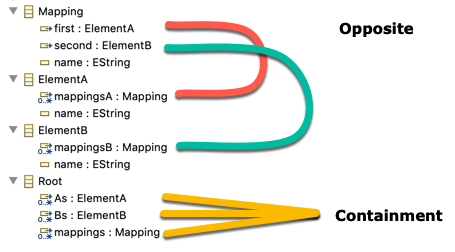

In my model, I have a Mapping object referencing two classes: ClassA and ClassB. These mappings are EOpposites. (please, see the image below representing the model)
index.php/fa/34919/0/

One thing to note up front is that if you have a bidirectional, proxy-resolving, cross reference, both ends must be serialized and hence both ends will initially have a proxy as the opposite. When either proxy is resolved, there is no need to resolve the other end because that resolution will happen when the other end's other proxy is resolved. But it sounds like you are manually setting a proxy, but doing so only on one end; that's just not going to work as you've observed. I'm not sure why you are manually settings proxies in the first place. What's the motivation for this approach? I.e., why are you not directly setting the value but rather populating the value with a proxy?
