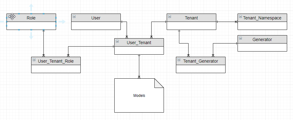

I want to create a forum for discussing the multi-tenancy concept of Vorto.
To start, in order to support Multi-tenancy, these are the changes I'm planning to implement in the database structure of Vorto.
Any thoughts, ideas, questions?

Also, please give some thoughts on this ideas for further refinement of the multi-tenancy concept:
- There is a default tenant.The default tenant has several predefined namespaces.
- Anonymous users (non-logged in users) can see the RELEASED models of the default tenant.
- A User_Tenant (a user belonging to a tenant) can only see his own models, the RELEASED models of other users of the same tenant, and the RELEASED models of the default tenant.
- Each tenant is configured with their own authentication and authorization providers on creation time.
- Each tenant has an admin configured on creation time.
- A tenant admin can add/remove/edit the namespaces associated with his tenant.
- A tenant admin can add/remove members of his tenant.
- Each tenant can either be open, or closed.
- Members who wish to join an open tenant doesn't need to be approved by the tenant admin.
- Members who wish to join a close tenant needs the approval of the tenant admin.

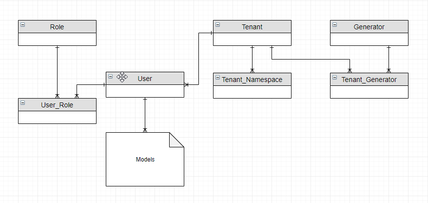

I decided to simplify a bit due to several factors:
1. The User table will not really hold a lot of data due to GDPR constraints, and the complexity that arises from normalizing the user and tenant relationship with a tenant_user table outweigh the redundancy of data that comes from tethering the User directly to Tenant in a one-to-many relationship.
