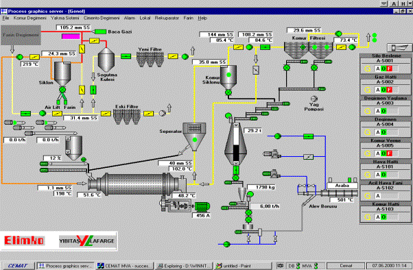

Could you please (4DIAC Developer) suggest me some SCADA softwares compatible to 4DIAC so i can make HMI etc (something like in the image), with enough source for tutorial how to use the software?

Regarding your question: Yes HMI is currently one of our weakest point. We improved here in the recent releases with our MQTT and OCP UA support. This allows to connect 4diac FORTE devices with a wide variety of systems.
If it would be only for HMI purposes I would suggest OPC UA and on the HMI side NodeJS, with node-opcua [1] and some application framework. With that you could develop quite nice Web-Based HMIs. However you would miss again alarms and historical data.
