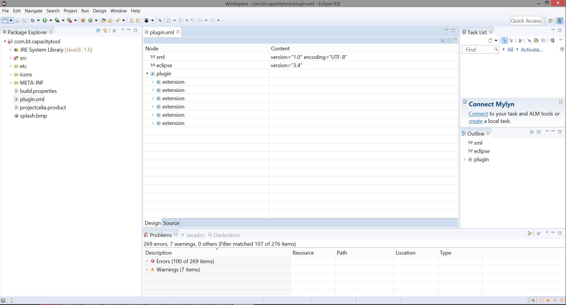

I am not able to see Project Celia which is under Testing and appears when we click on Launch an eclipse application.
In new version option of launch an eclipse application is missing. I have attached screenshot. Can you please help me.

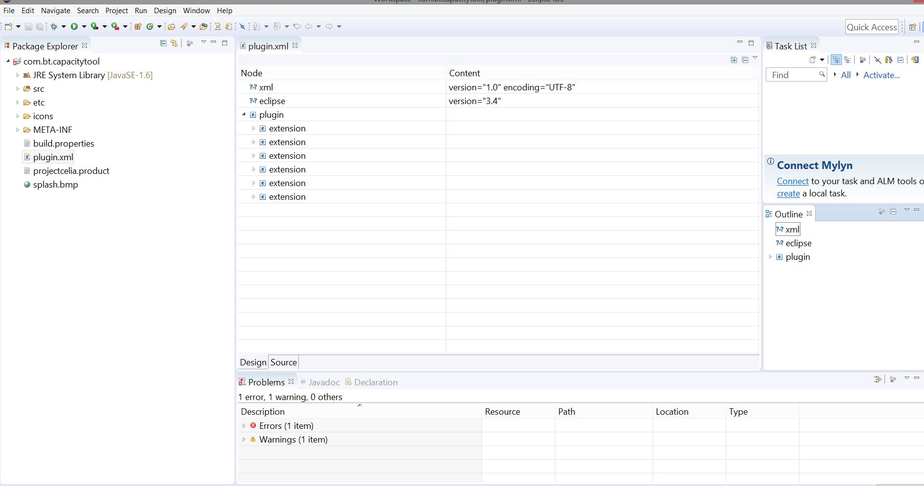

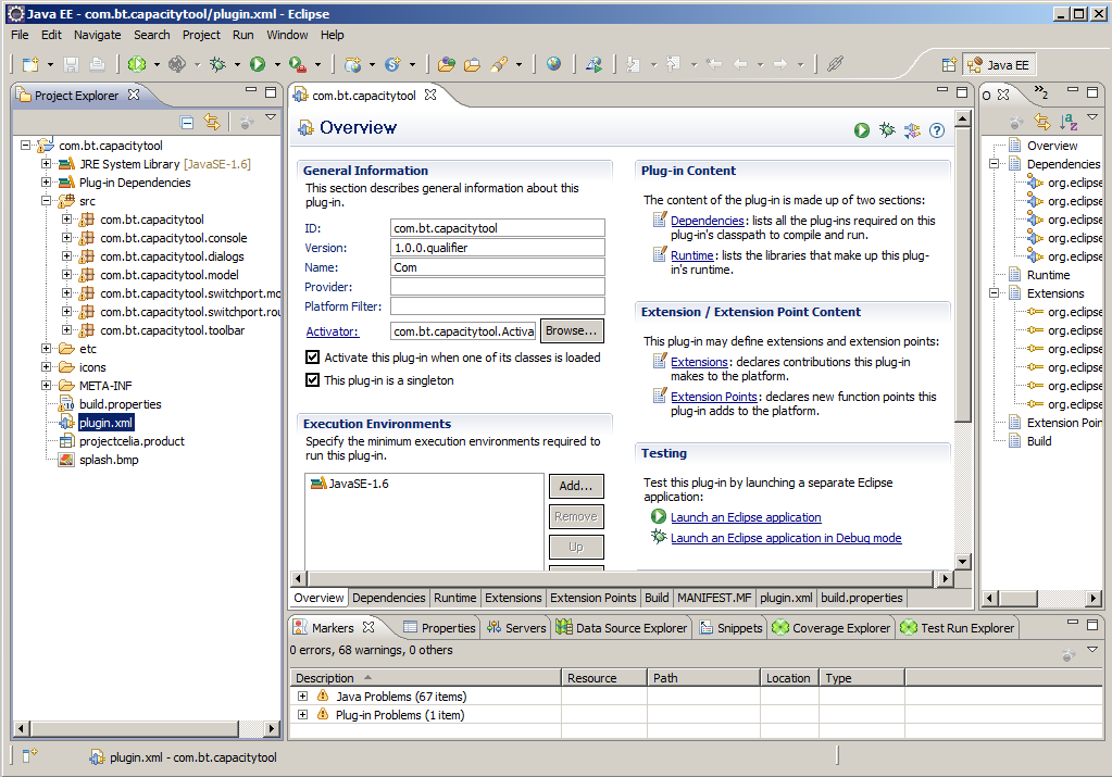

Thanks for your response. I have attached screenshots taken in both 3.5 and 4.9 version. You can see clearly that Under plugin.xml Testing option is present in version 3.5 while the same is missing under version 4.9
Can you please have a look and confirm where can I find this in new version of 4.9
Re: Launch an eclipse application missing in version 4.9 [message #1805446 is a reply to message #1805443] Mon, 15 April 2019 07:46 Go to previous messageGo to next message
In the second case, you're opening it with the XML editor, in the first case, you've opened it with the Plug-in Manifest editor. Is that option available on the context menu's Open With -> choices? If not, you don't have PDE installed...
