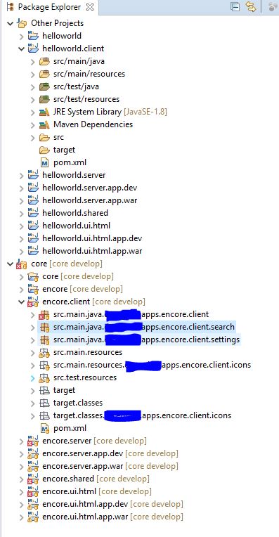

afte cloning my project from bitbucket, the package structure of my Scout project seems to be messed up.
Can I get help or advise how to import the project so it looks like the "Hello World" app again? I have attached a screenshot which shows both projects..

It looks like the Eclipse project settings are messed up.
If you've already updated the POMs accordingly for your Photon Migration, try regenerating the project settings from the POM.xml files:
Select the project(s) with the issue, and use the context menu "Maven -> Update Project" (Alt-F5) and select the three options "Update project configuration from pom.xml", "Clean projects" and "Refresh workspace resources from local filesystem". (The latter two are optional, but won't hurt)
If this worked and you haven't already done so, you might want to check in the .classpath and .project files into your SCM, otherwise you'll have to repeat this for every new clone.

Thank you- that did it :)
