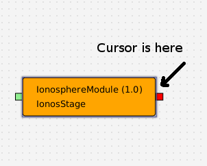

Re: GEF5 Add multiple parts to Group [message #1802406 is a reply to message #1802331] Fri, 08 February 2019 05:46 Go to previous messageGo to next message
Ok, so I've been trying a LOT of approaches and I think I got it right but there's still something missing:
index.php/fa/34843/0/
As you can see in the image, I can still just select the ModelPart and not the IOParts. The strange behavior I can observe is that when the mouse enters the IOPart width area, it automatically highlights the ModelPart with the ShapeOutlineProvider.
So, for some reason my group is bounded to the ModelPart bounds and I can't understand why.
Some help please :D

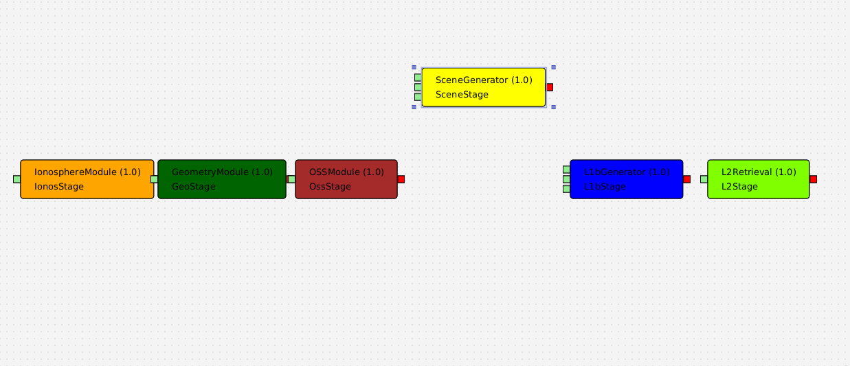

Re: GEF5 Add multiple parts to Group [message #1803099 is a reply to message #1802906] Fri, 22 February 2019 06:07 Go to previous messageGo to next message
Thanks for the answer Matthias!
I'm still facing problems with the Translation of my Group and wanted some feedback if possible.
So, currently I need to select my whole group parts, and if I do I can correctly move them (and the connections associated to the group - see image):
index.php/fa/34944/0/
However, I don't want to force the user to select all the Parts in order to move the Group. If the user selects the ChildPart he should also be able to move the whole GroupPart. In order to achieve this I added the following code to the bindChildPartAdapters:
