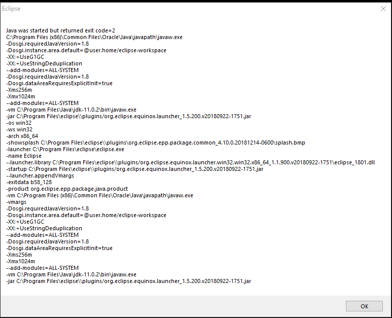

Can't install or run Eclipse IDE 2018‑12 in Windows 10. [message #1802240] Mon, 04 February 2019 23:29 Go to next message

Re: Can't install or run Eclipse IDE 2018‑12 in Windows 10. [message #1802243 is a reply to message #1802240] Tue, 05 February 2019 01:09 Go to previous messageGo to next message
You are running with a 32 bit JVM but have installed a 64 bit application. It's probably easiest/best to install either
Windows x64 207.46 MB jdk-8u201-windows-x64.exe
or
Windows x64 211.58 MB jdk-8u202-windows-x64.exe
from
https://www.oracle.com/technetwork/java/javase/downloads/jdk8-downloads-2133151.html
Re: Can't install or run Eclipse IDE 2018‑12 in Windows 10. [message #1802274 is a reply to message #1802243] Tue, 05 February 2019 12:11 Go to previous messageGo to next message
U mean latest JDK 11.2 is not enough alone?
Re: Can't install or run Eclipse IDE 2018‑12 in Windows 10. [message #1802297 is a reply to message #1802274] Wed, 06 February 2019 00:13 Go to previous message
The problem appears to be that installing Java 11 don't actually put Java 11 on the system PATH, so Eclipse's launcher will not find it, so you have to do manual steps as described here:
https://wiki.eclipse.org/Eclipse.ini#-vm_value:_Windows_Example
And similarly the Eclipse Installer will not find Java 11 either.
