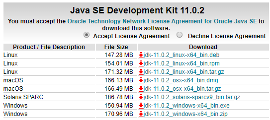

I installed Java SE Development Kit 11.0.2 x64 on Windows from the Oracle website and downloaded both the zip and exe files for Windows.

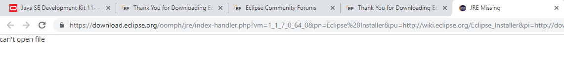

Then I downloaded an installer of Eclipse IDE 2018-12 and the file name is eclipse-inst-win64.exe. This was just downloaded in my downloads folder. When I clicked this executioner file, it opens with the internet browser (Google Chrome) and it says JRE missing on the tap and "can't open the file" in the main body.
index.php/fa/34798/0/
I am not sure what is wrong. I would really appreciate any help.

Thanks for providing such clear details in your question!
Did you install Java 11.0 using the *.exe or using the *.zip?
What you show via "Configure Java" is a JRE installation for Java 8 (not 11) , and that's definitely 32 bit because it's in the (x86) folder whereas a 64 bit version would be located in just C:/Program Files/Java...
So it seems the Java 11 you installed is not in the system registry (at least not in the "expected" place) such that even "Configure Java" can't find it. The Eclipse installer looks in the system registry and the system path. If it doesn't find what it needs in either of those, it will complain.
So you have two options, install Java 8, 64 bit, or change your PATH so that it finds Java 11 in C:/Program Files/Java/jdk-11.0.2/bin
But please do let me know how you worked this out and in particular whether you used the *.exe to install Java 11, because if you did, we have to figure out in the installer why this does not end up in the system registry (or at least not in the normal place where Java 8 is registered).

To answer your question, I installed Java SE Development Kit 11 using the executioner file (.exe.). I downloaded both zip and exe, but when I opened the zip folder, there was no executioner file, so I ran jdk-11.0.2_windows-x64_bin.exe.

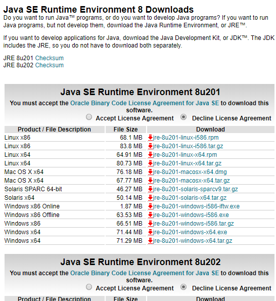

2) If I choose to install Java 8, 64, which file should I install? There are 8u201 nad 8u202 and each has .exe file and .tar.gz.

Of course easiest is to install Java 8 with *.exe. I guess 202 is newer, but either should be fine.

I was able to run Java properly now after installing Java 8. The PATH solutions were very difficult to follow.
