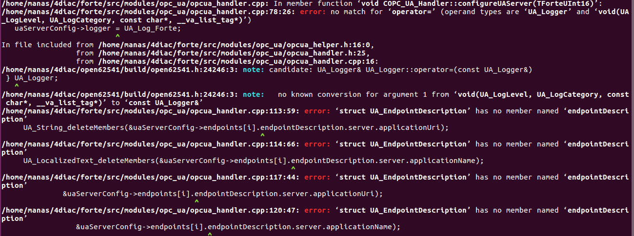

Dear All,
I am having issues while compiling OPC UA on linux (Ubuntu-16.04) after the command make -j.
PFA for the screenshot.
Do i have to build forte before running the below commands or the following command takes care of forte compilation for OPC UA.
Or Am i missing some steps.A hint will be great.
$ cd ~/4diac/forte/build
$ cmake -DCMAKE_BUILD_TYPE=Debug -DFORTE_ARCHITECTURE=Posix -DFORTE_MODULE_CONVERT=ON \ -DFORTE_COM_ETH=ON -DFORTE_MODULE_IEC61131=ON -DFORTE_COM_OPC_UA=ON \ -DFORTE_COM_OPC_UA_INCLUDE_DIR=$HOME/4diac/open62541/build \ -DFORTE_COM_OPC_UA_LIB_DIR=$HOME/4diac/open62541/build/bin \ -DFORTE_COM_OPC_UA_LIB=libopen62541.so \ -DFORTE_COM_OPC_UA_VERSION=master ..

unfortunately this is a Bug that slipped into the 1.10.1 release [1]. It is already fixed in the maintenance branch for the 1.10.x release train and will make it in the 1.10.2 release. In the meantime you can checkout the 4diac FORTE repository and take the latest version from the 1.10.x branch. Also we updated the OPC UA documentation to clearly state which open62541 version you should take.
Cheers,
Alois
[1] https://bugs.eclipse.org/bugs/show_bug.cgi?id=543532

Dear Sir,
Thanks for the information. I am able to compile it now.
