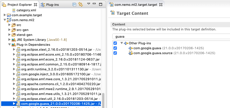

Re: NoSuchMethodError when running Maven [message #1801950 is a reply to message #1801948] Tue, 29 January 2019 13:35 Go to previous messageGo to next message
Guava 21 is listed both in the classpath and contents of the Target Definition file.

Re: NoSuchMethodError when running Maven [message #1801990 is a reply to message #1801951] Wed, 30 January 2019 07:53 Go to previous messageGo to next message
I tried adding adding Guava 21 to the list of dependencies in Maven, within exec-maven-plugin (which seems to execute them mwe2Launcher) and I saw no difference
Actually, the following warning suggests that I'm already working with the version 21.
WARNING: Skipping conflicting project com.google.guava at 'archive:file:/Users/claudenirmf/.m2/repository/com/google/guava/guava/14.0.1/guava-14.0.1.jar!/' and using 'archive:file:/Users/claudenirmf/.m2/repository/p2/osgi/bundle/com.google.guava/21.0.0.v20170206-1425/com.google.guava-21.0.0.v20170206-1425.jar!/' instead.
When I tried moving to Xtext 2.15 (by changing the version of xtext within maven and changing the repositories on the target file) I also got a NoSuchMethodError, but for a different method
org.eclipse.emf.codegen.ecore.genmodel.GenModel.clearCache...
This second error was even more strange because, as far as I was able to check, there was never a version of GenModel with such method.
Anyway, for now I'm working without Maven support. I'm probably going to leave it like this for a while and follow your discussion on the issue at GitHub.
