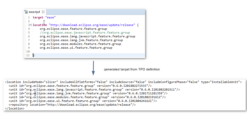

I am using eclipse TPD (http://download.eclipse.org/cbi/tpd/3.0.0-SNAPSHOT/) for defining the update site location and corresponding IU's , from this TPD configuration -> Target file is generated
Possible at present: By specifying keyword "lazy" for an IU in TPD, in the target file for the corresponding plugin -> version is generated as "0.0.0"
In my scenario, I do not want to hardcode "lazy" keyword at IU level, as I also have the usecase to generate the target file containing the latest available version info from the same TPD file.
Based on this, I am checking if there exists a central configuration for TPD file to specify if the model shall be "lazy" (to generate IU version as 0.0.0) or "default" (to generate latest available version in the update site for IU )

No, there is no configuration to change the behavior of lazy keyword. It always generates "0.0.0"
