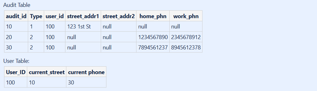

This is how my database looks like:
- Audit Table: Holds audit information regarding user.
- Audit_id is PK key and has a discriminator column.
- If discriminator value is 1, then it's Address details and if 2, it's Phone details.
- One user can have more than one audit records.
- User Table -> user_id is PK.
- It has a column called CURRENT_STREET column. Instead of storing string directly, it holds audit id. The audit id points to most recent change.
User id 100 has 2 audit rows for phone number. I couldn't get collection of results.
