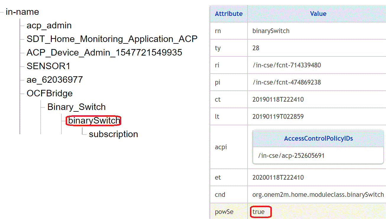

I want mqtt command to update the "powSe" field of binarySwitch( such as osgi.gif) from http binding. Below is my example, but the update failed. How to fix it?
mosquitto_pub -t "/oneM2M/req/OCFBridge/in-cse/json" -m "{\"m2m:rqp\":{\"m2m:fr\":\"admin:admin\",\"m2m:to\":\"/in-cse/in-name/OCFBridge/Binary_Switch/binarySwitch\",\"m2m:op\":3,\"m2m:rqi\":123456,\"pc\":{\"m2m:cin\":{\"cnf\":\"application/json\",\"con\":{\"hd:binSh\":{\"powSe\":\"true\"}}}},\"m2m:ty\":28}}"

"{\"m2m:rqp\":{\"m2m:fr\":\"admin:admin\",\"m2m:to\":\"/in-cse/in-name/OCFBridge/Binary_Switch/binarySwitch\",\"m2m:op\":3,\"m2m:rqi\":123456,\"m2m:pc\":{\"hd:binSh\":{\"powSe\":\"true\"}},\"m2m:ty\":28}}"
~~colse this question~~
