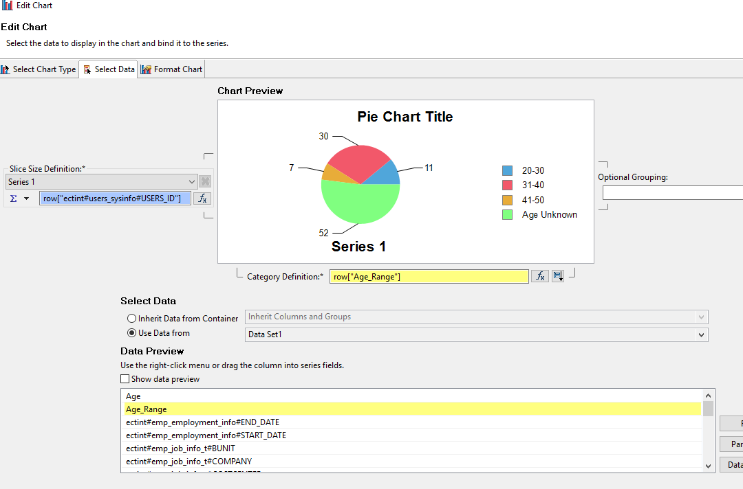

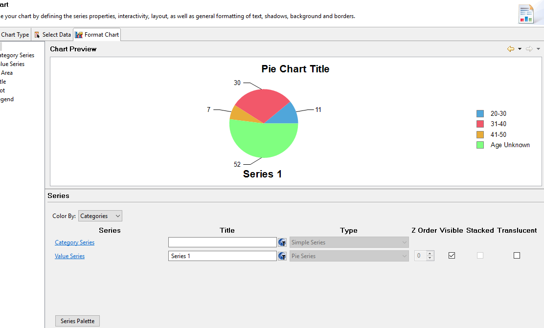

version : 2.6.0
Trying to display a simple Pie chart - Shows up in Preview of Chart dialogue box (screenshots attached) but not in main report preview received the following error:
