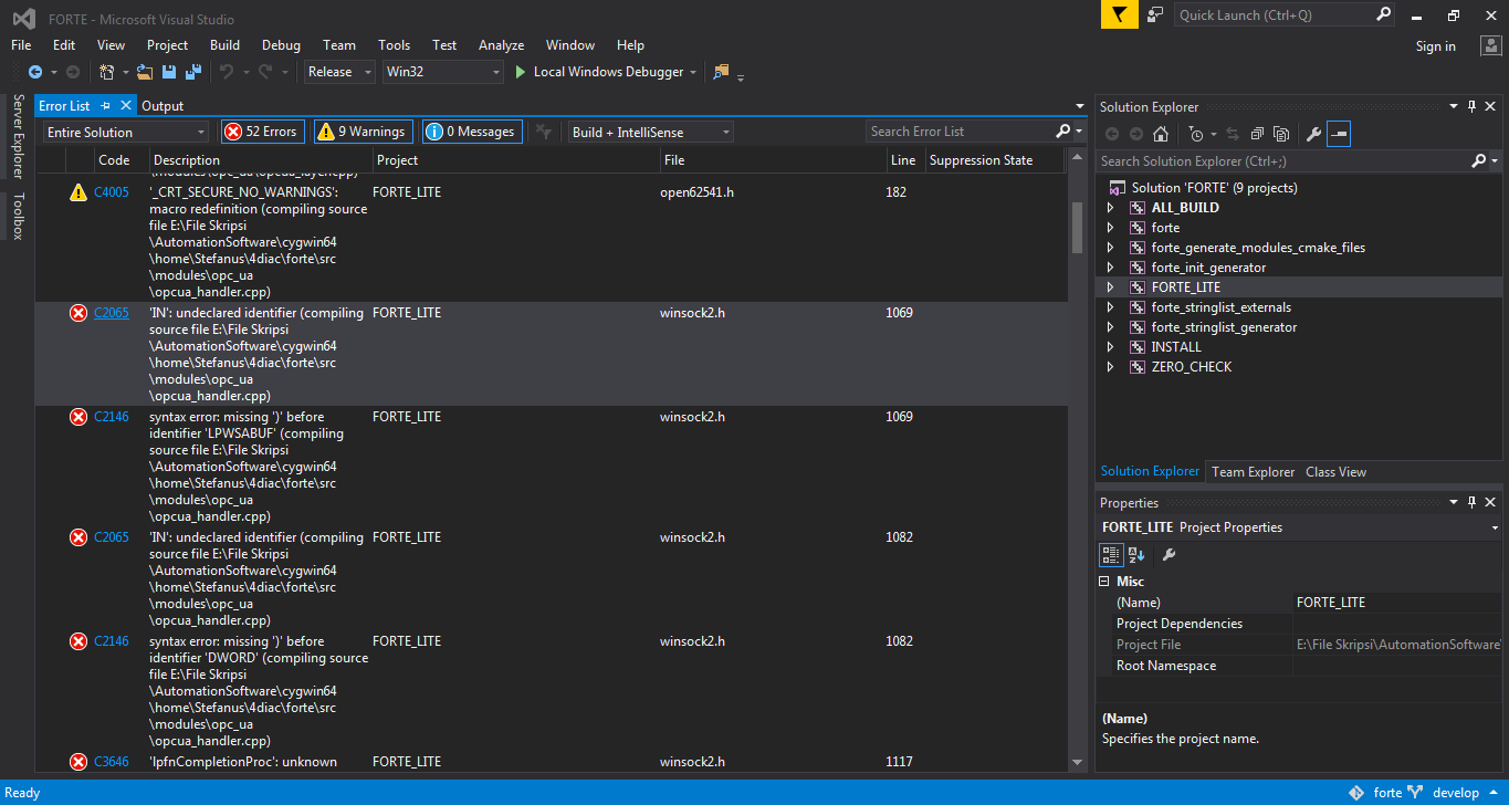

Morning all i've some problem in building forte with open62541 for my project,
i have read the instruction on https://www.eclipse.org/4diac/en_help.php?helppage=html/communication/opc_ua.html about configuring forte, and follow step by step in Windows with Visual Studio part. Acctually i'm using VS 2015 Community edition right now.
But at step 15 i got stuck with error, i attach with this post.
Is there anyone could help me solve this error?
Many thanks
  • Attachment: Capture.PNG
    (Size: 77.04KB, Downloaded 266 times)
Re: winsock2.h error when build FORTE [message #1801350 is a reply to message #1801333] Thu, 17 January 2019 06:03 Go to previous messageGo to next message
try to undefine IN in the opcua_handler. Some windows header add the preprocessor symbols IN and OUT, which can clash with FORTE code.
Martin

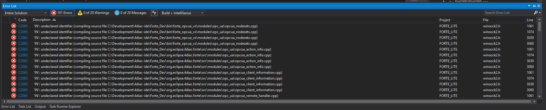

Re: winsock2.h error when build FORTE [message #1816992 is a reply to message #1801333] Wed, 13 November 2019 08:39 Go to previous messageGo to next message
I have the same issue when building forte with open62541.
forte:
Revision: f435b4e3b34e2a240ef48e52f2c06cc890a5204c
Merge branch '1.11.x' for 1.11.0 release
open62541:
Revision: 280012ee016e2f42ab9b1386174a8c12e6b29821
Message:
Included plugin/log.h cleanup in UA_Client_delete(..).
Kind regards,
René
Re: winsock2.h error when build FORTE [message #1817207 is a reply to message #1816992] Mon, 18 November 2019 09:46 Go to previous message
you're right. That's a problem that happens in VS. We managed once by moving the includes, but I couldn't handle with the OPC UA module.
Here another user experienced the same problem https://www.eclipse.org/forums/index.php/t/1101178/
Unfortunately the only solution now is to use with mingw-w64 https://sourceforge.net/projects/mingw-w64/
There's already a bug report for this: https://bugs.eclipse.org/bugs/show_bug.cgi?id=551161
