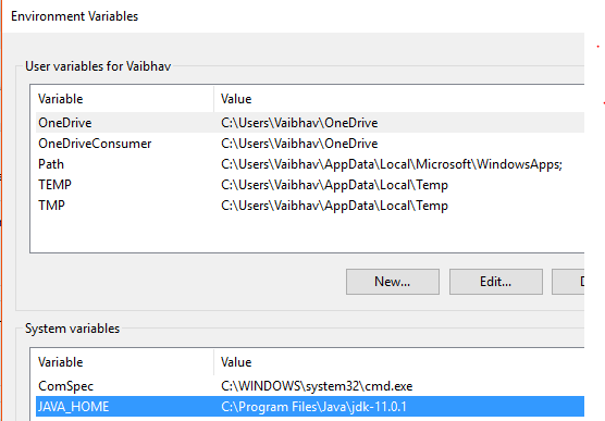

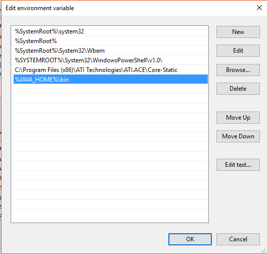

Using - jdk-11.0.1_windows-x64_bin
Attached images of Environment Variable

Yes, Oxygen does not work with Java 11. If you need Oxygen you must use an older JDK, if you need Java 11, you must install a newer version of Eclipse.
