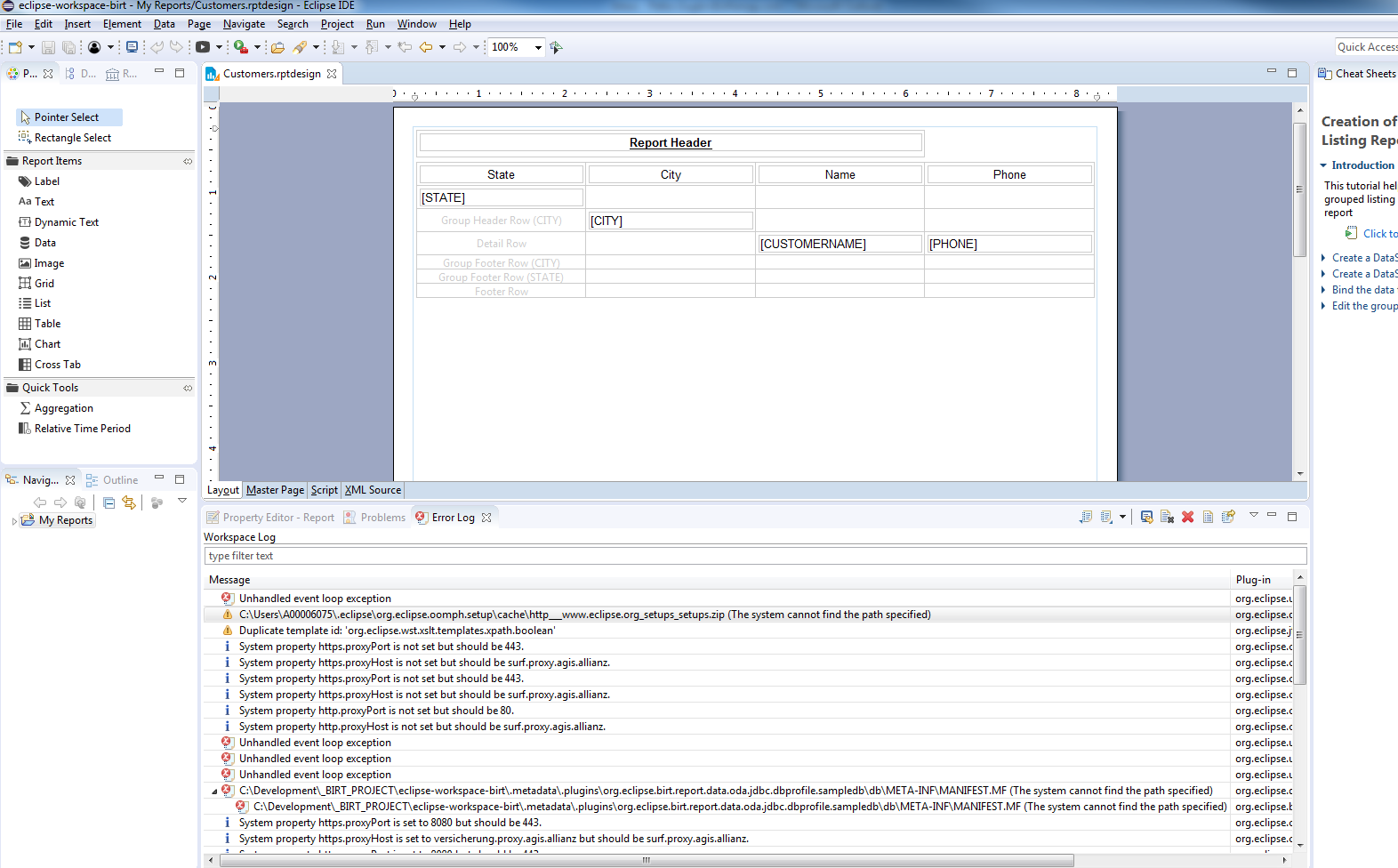

Hello all,
I downloaded the latest (currently 4.7.0) package of the Eclipse BIRT Designer, installed it and followed the tutorial to run the default sample (Customers) report. I did everything correctly without any problems but I am actually missing the Preview Tab. Additionally, I noticed I have an entry in the Error Log View that the following path is invalid:
...\eclipse-workspace\birt\.metadata\.plugins\org.eclipse.birt.report.data.oda.jdbc.dbprofile.sampledb\db\META-INF\MANIFEST.MF
I manually created the path, and created an empty MANIFEST.MF file. Then I restarted Eclipse. But, now I have the following in the Error Log View:

Is the problem actually, that I am behind a proxy? I managed to connect to the sample Customers database and ran the SQL query with test results successfully.
Any help would be appreciated! Thanks!

Hello again! Thank you for the quick reply! I installed 4.8, however I experience the same issue unfortunately: the Preview Tab is missing and I have the following error in the Error Log view:

at java.io.FileOutputStream.<init>(FileOutputStream.java:213)
at java.io.FileOutputStream.<init>(FileOutputStream.java:162)
at org.eclipse.birt.report.data.oda.jdbc.dbprofile.sampledb.internal.impl.SampleDbFactory.initSampleDb(SampleDbFactory.java:187)
at org.eclipse.birt.report.data.oda.jdbc.dbprofile.sampledb.internal.impl.SampleDbFactory.setInitializationData(SampleDbFactory.java:88)
... 59 more
!SUBENTRY 1 org.eclipse.birt.report.data.oda.jdbc.dbprofile.sampledb 4 0 2019-01-14 09:23:05.355
!MESSAGE C:\Development\_BIRT_PROJECT\_4.8.0\eclipse-workspace\.metadata\.plugins\org.eclipse.birt.report.data.oda.jdbc.dbprofile.sampledb\db\META-INF\MANIFEST.MF (The system cannot find the path specified)
!STACK 0
java.io.FileNotFoundException: C:\Development\_BIRT_PROJECT\_4.8.0\eclipse-workspace\.metadata\.plugins\org.eclipse.birt.report.data.oda.jdbc.dbprofile.sampledb\db\META-INF\MANIFEST.MF (The system cannot find the path specified)
at java.io.FileOutputStream.open0(Native Method)
at java.io.FileOutputStream.open(FileOutputStream.java:270)
at org.eclipse.core.internal.registry.ConfigurationElement.createExecutableExtension(ConfigurationElement.java:251)
at org.eclipse.core.internal.registry.ConfigurationElementHandle.createExecutableExtension(ConfigurationElementHandle.java:60)
at org.eclipse.datatools.connectivity.internal.InternalProfileManager.initializeLocalDatabase(InternalProfileManager.java:1380)
at org.eclipse.datatools.connectivity.internal.InternalProfileManager.loadLocalRegisteredDatabases(InternalProfileManager.java:1360)
at org.eclipse.datatools.connectivity.internal.InternalProfileManager.loadProfiles(InternalProfileManager.java:1070)
at org.eclipse.datatools.connectivity.internal.InternalProfileManager.getProfiles(InternalProfileManager.java:150)
at org.eclipse.datatools.connectivity.internal.InternalProfileManager.getProfilesByCategory(InternalProfileManager.java:200)
at org.eclipse.datatools.connectivity.ProfileManager.getProfilesByCategory(ProfileManager.java:88)
at org.eclipse.datatools.connectivity.ui.wizards.NewConnectionProfileWizardPage.createControl(NewConnectionProfileWizardPage.java:158)
at org.eclipse.jface.wizard.Wizard.createPageControls(Wizard.java:176)
at org.eclipse.datatools.connectivity.ui.wizards.NewConnectionProfileWizard.createPageControls(NewConnectionProfileWizard.java:309)
at org.eclipse.jface.wizard.WizardDialog.createPageControls(WizardDialog.java:682)
at org.eclipse.jface.wizard.WizardDialog.setWizard(WizardDialog.java:1122)
at org.eclipse.jface.wizard.WizardDialog.updateForPage(WizardDialog.java:1175)
at org.eclipse.jface.wizard.WizardDialog.lambda$3(WizardDialog.java:1163)
at org.eclipse.swt.custom.BusyIndicator.showWhile(BusyIndicator.java:71)
at org.eclipse.jface.wizard.WizardDialog.showPage(WizardDialog.java:1163)
at org.eclipse.jface.wizard.WizardDialog.nextPressed(WizardDialog.java:858)
at org.eclipse.jface.wizard.WizardDialog.buttonPressed(WizardDialog.java:407)
at org.eclipse.jface.dialogs.Dialog.lambda$0(Dialog.java:619)
at org.eclipse.swt.events.SelectionListener$1.widgetSelected(SelectionListener.java:81)
at org.eclipse.swt.widgets.TypedListener.handleEvent(TypedListener.java:249)
at org.eclipse.swt.widgets.EventTable.sendEvent(EventTable.java:86)
at org.eclipse.swt.widgets.Display.sendEvent(Display.java:4118)
at org.eclipse.swt.widgets.Widget.sendEvent(Widget.java:1052)
at org.eclipse.swt.widgets.Display.runDeferredEvents(Display.java:3931)
at org.eclipse.swt.widgets.Display.readAndDispatch(Display.java:3534)
at org.eclipse.jface.window.Window.runEventLoop(Window.java:818)
at org.eclipse.jface.window.Window.open(Window.java:794)
at org.eclipse.birt.report.designer.data.ui.actions.NewDataSourceAction.run(NewDataSourceAction.java:127)
at org.eclipse.jface.action.Action.runWithEvent(Action.java:473)
at org.eclipse.jface.action.ActionContributionItem.handleWidgetSelection(ActionContributionItem.java:565)
at org.eclipse.jface.action.ActionContributionItem.lambda$4(ActionContributionItem.java:397)
at org.eclipse.e4.ui.internal.workbench.swt.PartRenderingEngine$5.run(PartRenderingEngine.java:1170)
at org.eclipse.e4.ui.internal.workbench.swt.PartRenderingEngine.run(PartRenderingEngine.java:1059)
at org.eclipse.e4.ui.internal.workbench.E4Workbench.createAndRunUI(E4Workbench.java:153)
at org.eclipse.ui.internal.Workbench.lambda$3(Workbench.java:667)
at org.eclipse.ui.internal.Workbench.createAndRunWorkbench(Workbench.java:597)
at org.eclipse.ui.internal.ide.application.IDEApplication.start(IDEApplication.java:152)
at org.eclipse.equinox.launcher.Main.invokeFramework(Main.java:656)
at org.eclipse.equinox.launcher.Main.basicRun(Main.java:592)
at org.eclipse.equinox.launcher.Main.run(Main.java:1498)
My eclipse installation is a pristine designer installation, as installed from the zip, with the exception, that I configured manual proxies. The default JAVA installation the designer uses is 1.8 JDK.
Re: Preview Tab Missing In Designer [message #1801121 is a reply to message #1801119] Mon, 14 January 2019 04:38 Go to previous message
Hi again. FYI, report actually starts when I execute it via Run->View Report->In Web Viewer. So the only issue I currently have is the missing Preview.
