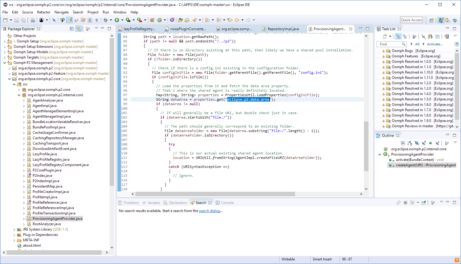

To add to Zak's question what is the purpose of the eclipse.p2.data.area defined in ProvisioningAgentProvider.java in the oomph P2 Management project in the Oomph source code as in the screen shot below:
index.php/fa/34625/0/
Is this supposed to be used by the eclipse installer or the eclipse application only. We have tried to specify the location using -Declipse.p2.data.area system property to the windows environment variable eclipse_p2_data_area and this does not appear to get used ever.

The eclipse.p2.data.area is used/defined by, for example, org.eclipse.equinox.internal.p2.core.Activator.PROP_AGENT_DATA_AREA.
