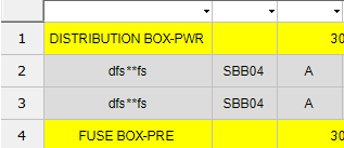

I am using Nattable filter functionality, some of my values in column cell contains string with "*" in it. on apply of filter if i select any value in filter drop-down the rows are not getting filtered correctly.

You are using the ComboBoxFilterRowHeaderComposite which by default uses the TextMatchingMode.REGULAR_EXPRESSION. The asterisk is a special character with regards to regular expressions. So I suppose that is the reason for the behavior.
I actually don't understand your code. Why do you set the filter row invisible and select all values as selected? And why do you expect that something gets filtered even you have actually no filter applied?

Actually as per myrequirement, the filter row is only visible on a toggle action. and when the toggle is yes, the filter row should be visible with all filter values as selected and then user can drill down by unchecking non required values from the filter combo.
Do u have any sample where i can bypass the "*" behavior and make it work like any other character.

Unfortunately not. But actually I wonder why it is not working. If I try something similar in the ExcelLikeFilterRowExample by editing some values with adding asterisks, it seems to work like it should. Maybe you want to test here and compare with your implementation.
In ComboBoxGlazedListsFilterStrategy#getStringFromColumnObject() the selected values from the combo boxes are quoted. This way special characters like asterisks should be treated as any other character. Therefore I don't understand why it is not working in your environment. Maybe you need to debug to see how the filter expression looks like in your error case.
