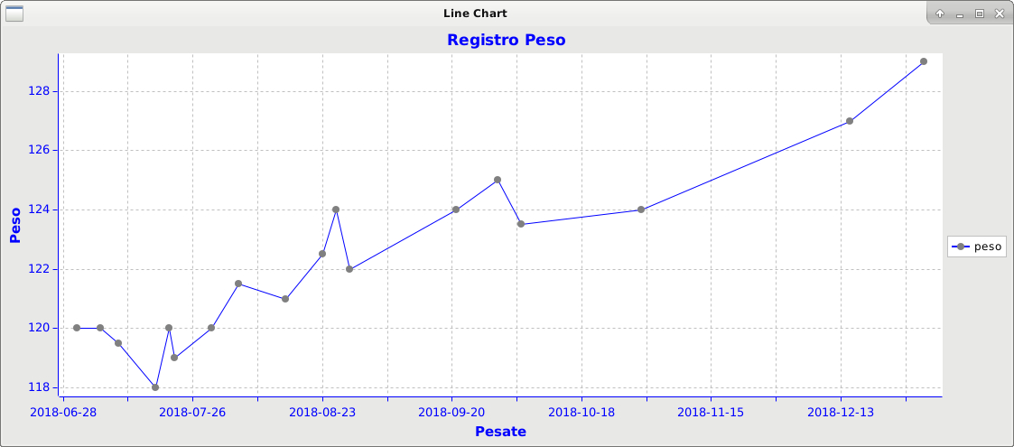

I read the official documentation, about chapter 2.5.5 "DateFormat format = new SimpleDateFormat("HH:mm");" I need to set SimpleDateFormat() as YYYY-MM-DD, but the chart print bad date.
furthermore I would like all the dates I pass as a value to the x axis to be printed.
Re: explanations on formatting the x axis as datetime [message #1800702 is a reply to message #1800616] Sun, 06 January 2019 03:59 Go to previous message
I solved part of the problem, it would seem that by inserting YYYY-MM-DD are inserted the days of the year from 1 to 365, instead with YYYY-MM-D the days of the month.but remains the problem of displaying the days that I pass as values, they are now given randomly.FOr example the first date i pass as value is 2018-07-01
