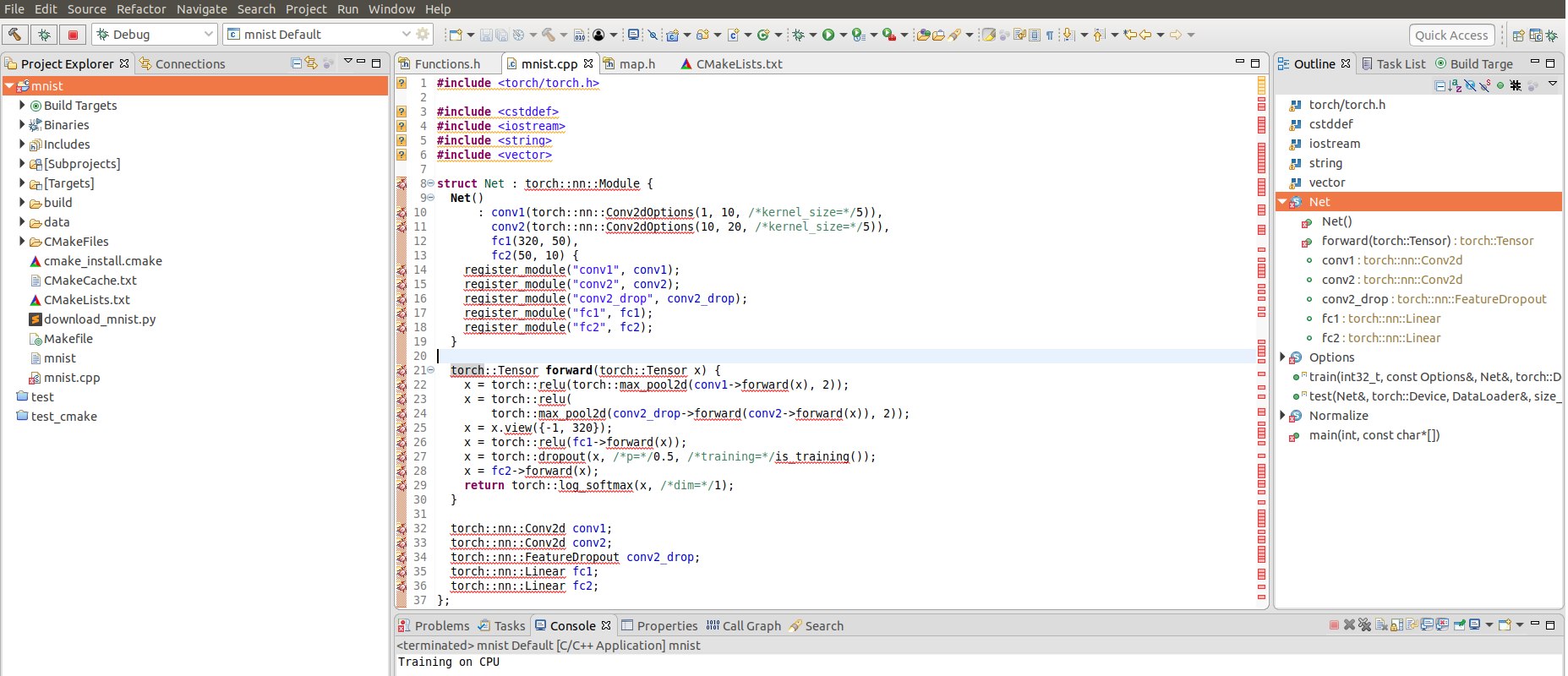

Attached is what I see, and additionally when I move my mouse on each of the functions, I get "function xxxx could not be resolved", i.e. the "Open Declaration" does not work. I need to mention that all these indexing were working before going into the debug mode, and I was able to "Open Declaration" for any function.

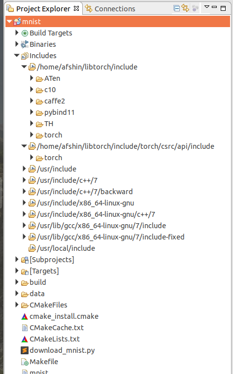

It seems that the "includes" are not being found. What does it say when you put your mouse over the "includes"? Also, expand the "Includes" folder on the project manager. What do you see there?
Re: Indexing problem after debugging [message #1800743 is a reply to message #1800741] Mon, 07 January 2019 10:48 Go to previous messageGo to next message
When I move the mouse on the include, I see "Unresolved inclusion: <torch/torch.h>". and in the include folder I see:
index.php/fa/34623/0/
