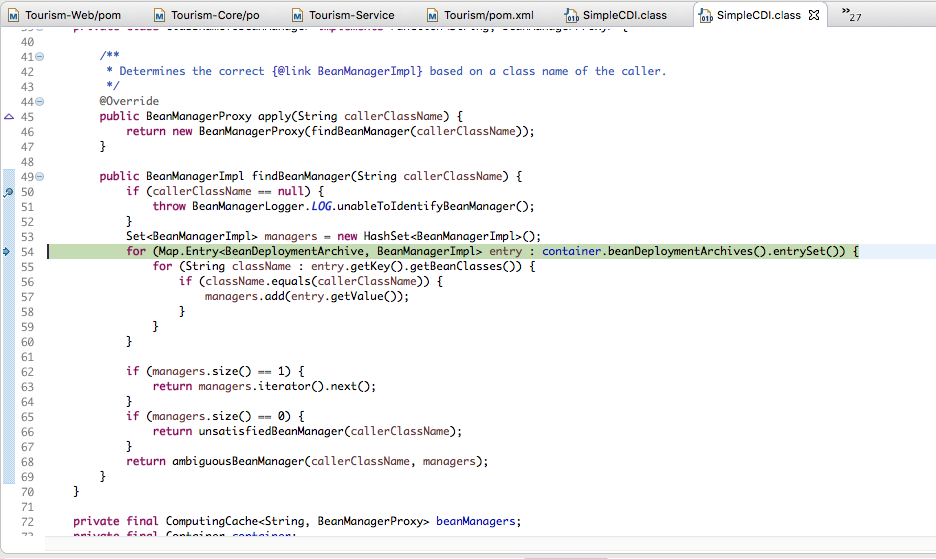

I posted this question on stackoverflow and had this answer :
This is likely a configuration issue only.
This is the code that's triggering your error ...
https://github.com/weld/core/blob/6c2b09fac4e694a20877f017424acd6c4b3e3439/impl/src/main/java/org/jboss/weld/SimpleCDI.java#L50-L71
When CDI initializes it sees multiple Bean Managers.
Put a breakpoint in the for loop in that code so you can debug and see where it's pulling those Bean Managers from.

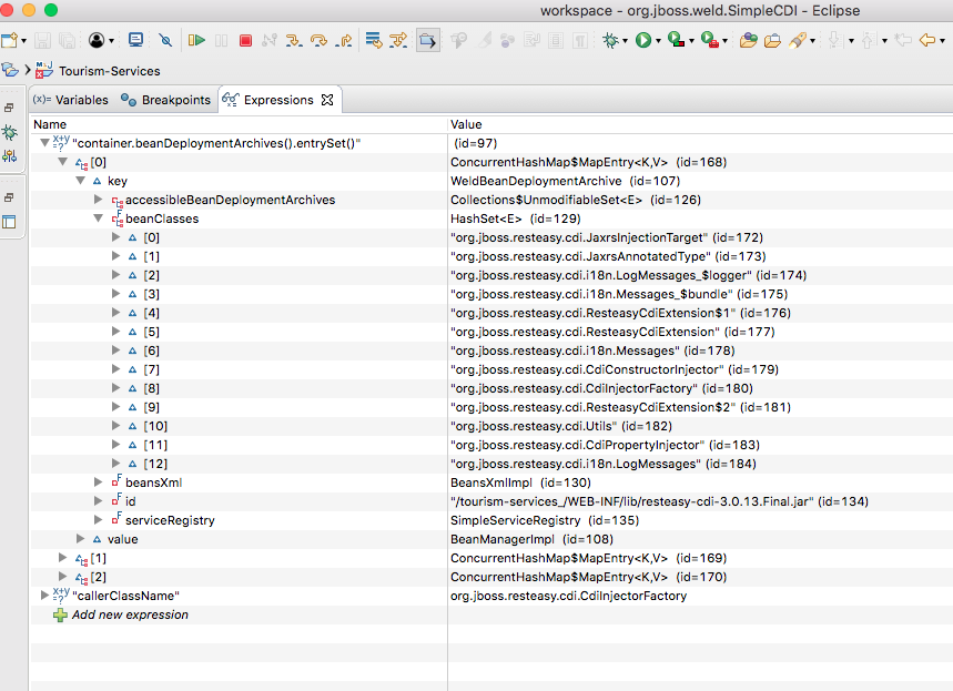

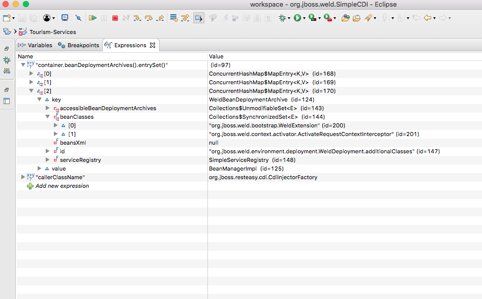

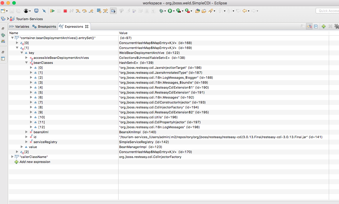

So I debugged it putting a breakpoint
index.php/fa/34565/0/
and here are three debug windows print screen
index.php/fa/34566/0/
index.php/fa/34567/0/
index.php/fa/34568/0/
Do you understand the signification of the code and if so could you explain me where is the error ?
It seems that the deployment takes into account twice the dependencies and there is a conflict between ones included in WEB-INF/lib and the dependencies coming from local maven repository (../.m2/repository/...)

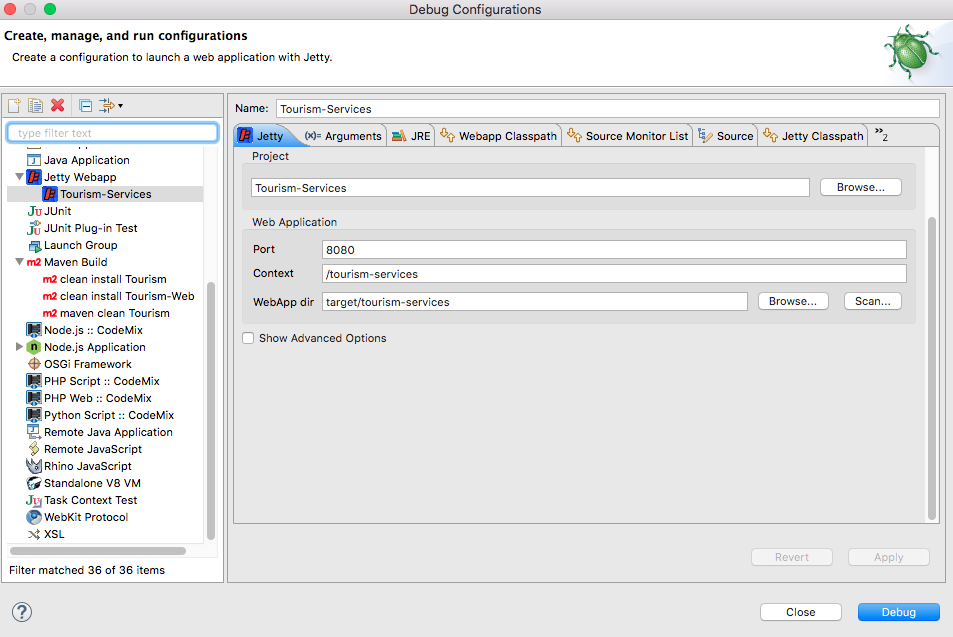

Here is the configuration of Jetty on Eclipse
index.php/fa/34569/0/
