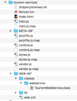

I have a war that I want to deploy and run on Jetty. It is an angular-Java project that I built on Eclipse-Maven
(see image1.png attached)
index.php/fa/34561/0/

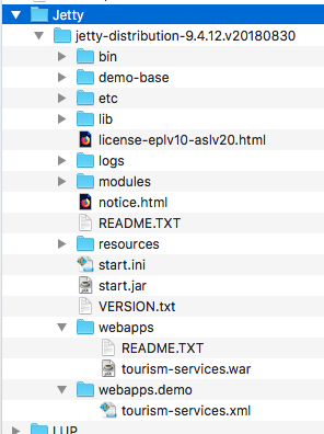

I have also downloaded Jetty 9 on my mac and here is a print screen of the hierarchy
(see image2.png attached)
index.php/fa/34562/0/

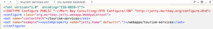

As you can see, according to a post that I found on internet (and that I didn't keep a trace of), I put my war file under webapps directory and I created a webapps.demo directory with a tourism-services.xml file, which is the following
(see image3.png attached)
index.php/fa/34563/0/

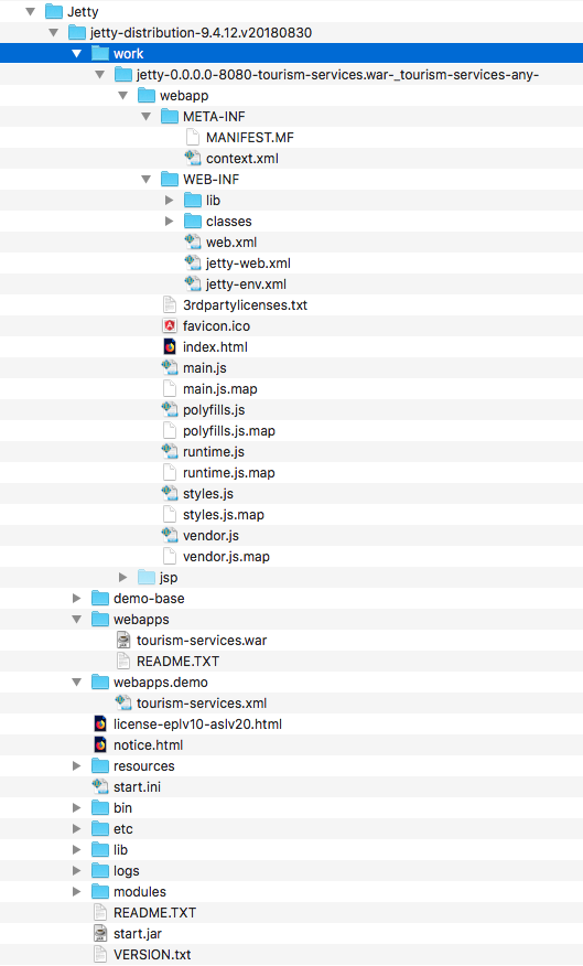

To get the exploded war, I created a work directory under JETTY_HOME and run again the java command, and I obtain the exploded war in the work directory
(see image4.png attached)
index.php/fa/34564/0/
But when I look at http://localhost:8080/tourism-services or http://localhost:8080/tourism-services/index.html address in my browser, there is the following error displaying in my console :
javax.ws.rs.NotFoundException: RESTEASY003210: Could not find resource for full path: http://localhost:8080/tourism-services/[index.html]
