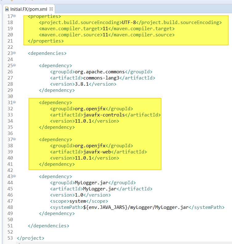

my POM:
index.php/fa/34533/0/

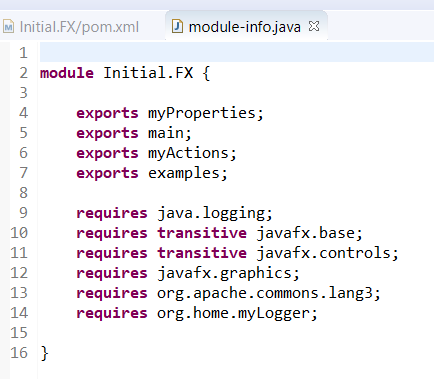

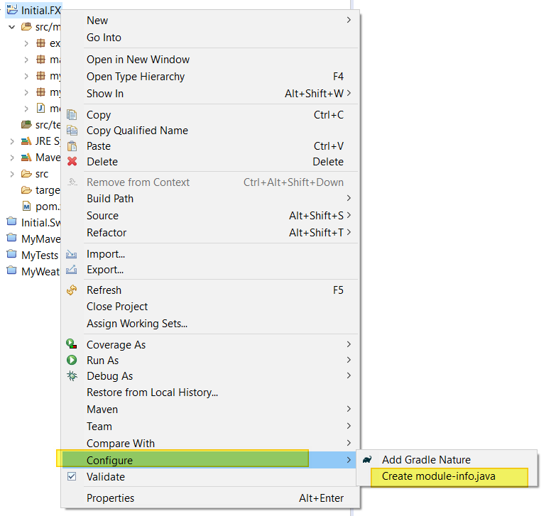

I also created module-info.java:
index.php/fa/34534/0/
the file created looks like this:
index.php/fa/34535/0/

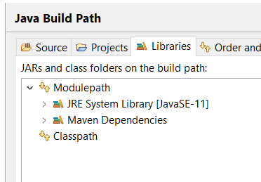

My build path looks like this (done automatically):
index.php/fa/34537/0/

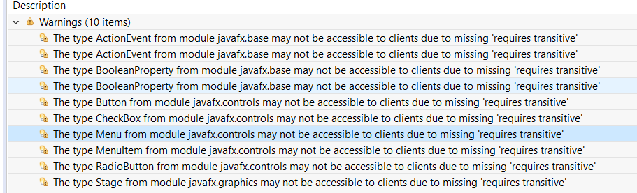

Re: Maven Dependencies in Module Path in Runconfiguration [message #1800157 is a reply to message #1800156] Thu, 20 December 2018 10:01 Go to previous messageGo to next message
The "transitive" was added manually because the compiler was not happy.... ;-)
index.php/fa/34538/0/

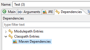

Re: Maven Dependencies in Module Path in Runconfiguration [message #1800160 is a reply to message #1800143] Thu, 20 December 2018 11:16 Go to previous messageGo to next message
I've done pretty much the same thing, which works for building:
index.php/fa/34540/0/
But when creating a regular run configuration, the maven dependencies end up in the class path with seemingly no way to change that:
index.php/fa/34541/0/

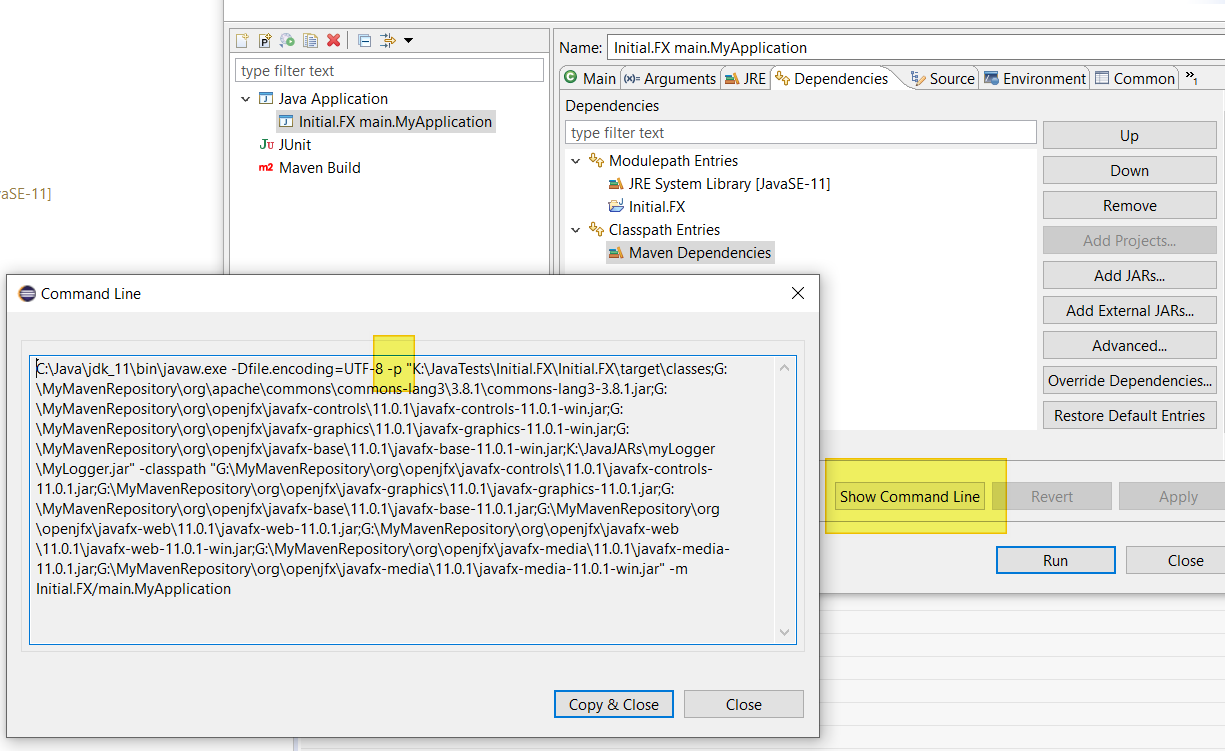

Re: Maven Dependencies in Module Path in Runconfiguration [message #1800165 is a reply to message #1800160] Thu, 20 December 2018 13:09 Go to previous messageGo to next message
This what I have in the run configuration (looks like yours)
But if hit the "show command line" we can see that the command line include -p
index.php/fa/34543/0/
which stands for:
--module-path modulepath... or -p modulepath (from https://docs.oracle.com/en/java/javase/11/tools/tools-and-command-reference.html )
Looks like a discrepancy between run configuration dialog and the java build path dialog or am I missing something...
Do you have module-info.java ?
Re: Maven Dependencies in Module Path in Runconfiguration [message #1800166 is a reply to message #1800165] Thu, 20 December 2018 13:20 Go to previous messageGo to next message
I do have a module-info.
But when I click show command line, the maven dependencies are listed only as -classpath, manually executing the command with them moved to -p works.
edit: But I just noticed another thing. While "Maven Dependencies" itself is listed as "Is modular" in the build path settings, the actual dependencies themselves are listed as "Is not modular - non modifiable". But the dependencies are clearly modular as they contain module-info.class and are usable when building with maven/jlink directly.
