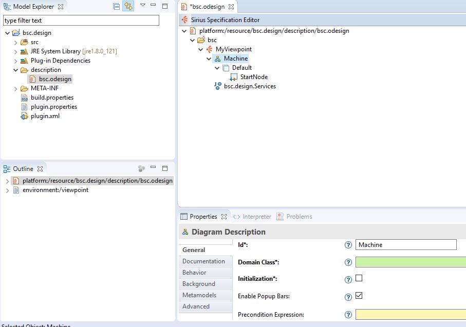

Hi!
I just started learning little bit about Sirius. I wanted to create my own project but I'm stuck on the begining already and I don't know what to do. So first I have already done this started tutorial on Sirius site where they use already example of family.
Now I'm confused what should I use when I want to create my own.
I have already seen that someone asked about this same problem and someone put the starter tutorial link and that doesn't help me.
I want to get diagram of this one node that I created. But how to do that when I don't have Metamodel? How do I create one? Why do I always have to use the ones from sirius (family)?
Also I'm confused what should be my Domain Class?
  • Attachment: sirius.JPG
    (Size: 68.75KB, Downloaded 136 times)
Re: Viewpoint Specification Project [message #1799988 is a reply to message #1799983] Tue, 18 December 2018 08:34 Go to previous message
There is a documentation dedicated to specifiers [1] that presents the features of the Viewpoint Specification Project (RepresentationDescriptions, Mappings, Styles...). Feel free to import the "Modeler Definition" project of the BasicFamily example you used in the tutorial (New>Example...>Sirius Examples) and modify it to test each features.
Indeed, you will first need a Metamodel, as Sirius displays graphical editors specified for a Metamodel. You can define your Metamodel directly with EMF[2] or you can use EcoreTools[3] a Sirius modeler dedicated to Metamodel creation.
