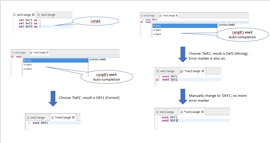

And the above mentioned issue can be reproduced as shown in the image below
index.php/fa/34485/0/
The different between LangB-"use1"-way and LangB-"use2"-way is the cross-reference is specified with a keyword (works) and does not work when cross-reference is in its own object/rule i.e UseRef.
I do not understand the behaviour. helps if you can clarify it.
Attached is the source code to reproduce the issue.
[Updated on: Mon, 10 December 2018 09:54] by Moderator
Re: cross-reference with modified name [message #1799599 is a reply to message #1799584] Mon, 10 December 2018 16:18 Go to previous messageGo to next message
this is a different problem.
Xtext creates objects lazy (usually)
that means "after" the first assignment
in your grammar you have
Use2:
'use2' name=UseRef ;
UseRef:
name=[langA::Definition]
=> the context may be a Use2 or even a Model (depending on situation), that is expected behaviour.
=> you have to consider that in your scoping impl.
you can otherwise mitigate it by changing the grammar (depends on the situation if this is possible)
Use2:
name=UseRef ;
UseRef:
{UseRef}'use2' name=[langA::Definition]
the label in the completion is done there:org.eclipse.xtext.resource.impl.AliasedEObjectDescription.getQualifiedName()
called by org.eclipse.xtext.ui.editor.contentassist.AbstractContentProposalProvider.getStyledDisplayString(IEObjectDescription)
you might custoize that in your proposal provider
Re: cross-reference with modified name [message #1799605 is a reply to message #1799599] Mon, 10 December 2018 19:47 Go to previous message
