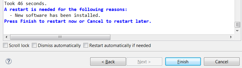

Re: Install requirements on startup "Always" not working [message #1799360 is a reply to message #1799353] Wed, 05 December 2018 10:17 Go to previous messageGo to next message
I expect the status icon stays there are stays animated with the exclamation mark to catch the user's attention. The dialog itself gives you the option to restart, which it will do if you hit finish (and it will not do if you hit cancel). Isn't that the case?

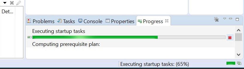

I don't see any dialog. Just a progress bar. I attached a picture file.
Re: Install requirements on startup "Always" not working [message #1799389 is a reply to message #1799374] Thu, 06 December 2018 00:39 Go to previous messageGo to next message
For me I see the following icon the entire time the tasks are executing. It's animated and you can click it any time to bring up the dialog. The dialog itself has an icon next to to its progress bar to hide the dialog again. When tasks finish performing successfully without action required, the icon disappears after a short while. If there is a restart needed, it animates with and orange exclamation mark (and if something failed, it animates with an red x). It looks like this:
index.php/fa/34467/0/
When you click on it, the dialog looks like this:
index.php/fa/34468/0/

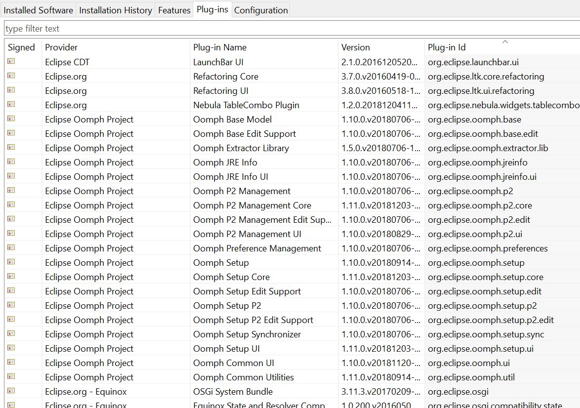

Do I have sufficient Oopmh plugins installed? See attached screen capture.
Re: Install requirements on startup "Always" not working [message #1799453 is a reply to message #1799422] Thu, 06 December 2018 23:19 Go to previous messageGo to next message
The org.eclipse.oomph.setup.editor seems missing and indeed that's what contributes org.eclipse.oomph.setup.presentation.handlers.PerformStatusControl.
