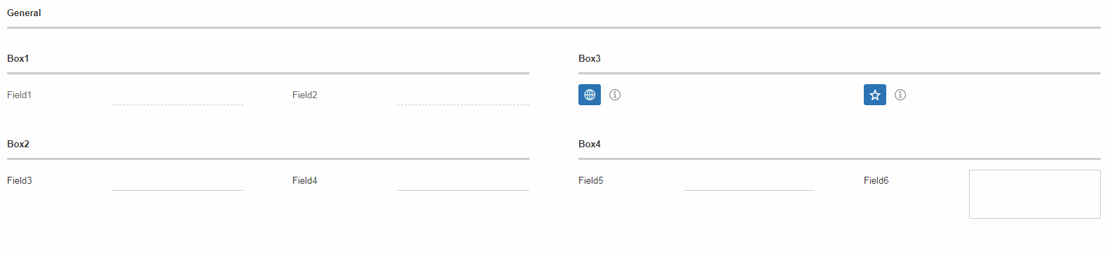

i have a question about the layouting of a form.
This form is attached on a tablepage as a detailform.
What i need to have is, that all fields are in the left side of the form.
So like you see in the picture, that box 3 and box 4 should be positioned under box 2, so that all boxes are positioned on the left side and the right side is just plain empty. Is this possible?
At the moment my code (simplified for layout) looks like that:

Re: Layout on Form Scout 8 [message #1799153 is a reply to message #1799141] Fri, 30 November 2018 09:53 Go to previous messageGo to next message
Sure, that should be possible.
You can make a "left group box" and a "right group box" directly inside the main box. Make each of them 1 Unit wide. If you want, hide the border and label of the group boxes (left and right).
Make sure the main group box has a column count of 2 (should be the default).
Then add your boxes to the left group box only and you're almost done.
Now the trick: Since the right box would be empty (for now), Scout would remove it. To prevent this, add a PlaceholderField (AbstractPlaceholderField, or empty LabelField) to the right group box.

Re: Layout on Form Scout 8 [message #1799252 is a reply to message #1799153] Mon, 03 December 2018 08:58 Go to previous message
Thanks a lot!
The trick was the part i was missing before, already been there but i was wondering why the box was just ignored/removed.
Thx again for sharing your magic with us here :)
