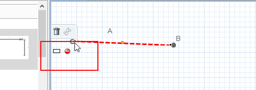

What doesn't work is when the elements on which the ContextButtonPad can by seen are placed at the border of the editor window, like this:
index.php/fa/34405/0/
Now the ContextButtonPad is expanding to the left and i would have to scroll horizontally to see the other 3 context buttons.

I solved the Issue by adjusting width and height of the ContextButtonPad.
int x = context.getPictogramElement().getGraphicsAlgorithm().getX();
int y = context.getPictogramElement().getGraphicsAlgorithm().getY();
data.getPadLocation().setRectangle(x + 5, y, 5, 120);
By reducing the width and increasing the heigth, the buttons seem to be forced into the vertical, which is good enough for me.
My initial fault was to not set x and y correctly, so the pad wouldn't display.
Here's the result:
index.php/fa/34414/0/
Thanks for your help!
Felix
