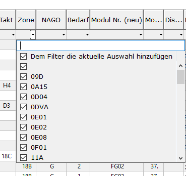

Re: Sorting removes applied filters [message #1802726 is a reply to message #1802723] Thu, 14 February 2019 11:54 Go to previous messageGo to next message
I don't understand what you mean with filter list
Re: Sorting removes applied filters [message #1802762 is a reply to message #1802726] Fri, 15 February 2019 05:09 Go to previous messageGo to next message
index.php/fa/34899/0/I attached a screenshot showing the mentioned filter.
Re: Sorting removes applied filters [message #1802765 is a reply to message #1802762] Fri, 15 February 2019 05:40 Go to previous messageGo to next message
ah okay, the combo box filter stuff ... yes I can reproduce that with the _813_SortableGroupByWithComboBoxFilterExample
looks like some synchronization issue that leads to clearing the filters in case the sorting happens while building updating the filter combo values. Could be located in FilterRowComboBoxDataProvider ... but that needs to be investigated in more depth then.
