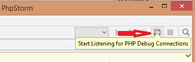

I currently use PHPStorm to debug a phpBB Board, but my (free) academic license is about to expire, and I'm looking for a free alternative. I'm checking out Eclipse PDT, but the behavior seems different.
In PHPStorm, I can set breakpoints and then enable debugging by clicking the debug icon as shown here:
index.php/fa/34397/0/
I can then launch Chrome, navigate to my site, and choose "Debug" from the Chrome XDebug plug-in as shown ihere:
index.php/fa/34398/0/
Then as I operate my website in Chrome and encounter the breakpoint, PHPStorm comes to the fore and permits me to examine variables.
I believe I have set XDebug as my debug agent in PDT, but I don't encounter breakpoints I have set as I navigate my site in Chrome. I think I may have hit breakpoints using the internal browser, but I can't seem to reproduce it reliably - and, I would really like to operate the browser independent of PDT, as I did with PHPStorm. Is it possible, and is it simply the case that I may have misconfigured PDT for debugging? And leads would be much appreciated.

PDT listen for incoming xdebug connections from localhost by default, so you can start using chrome xdebug helper. But if phpstorm claim port, eclipse might not work.
You can configure this behaviour in settings. Internal browser isn't requirement and can be easy configured in eclipse settings.

Thank you! I was running Eclipse when PHPStorm was not running - so they were not stepping on each other's toes. But I found this wonderful article:
https://wiki.eclipse.org/Debugging_using_XDebug
...and now I am running PDT/XDebug/Chrome! It's working perfectly. I have a lot to learn about Eclipse, but this will definitely work for me.
