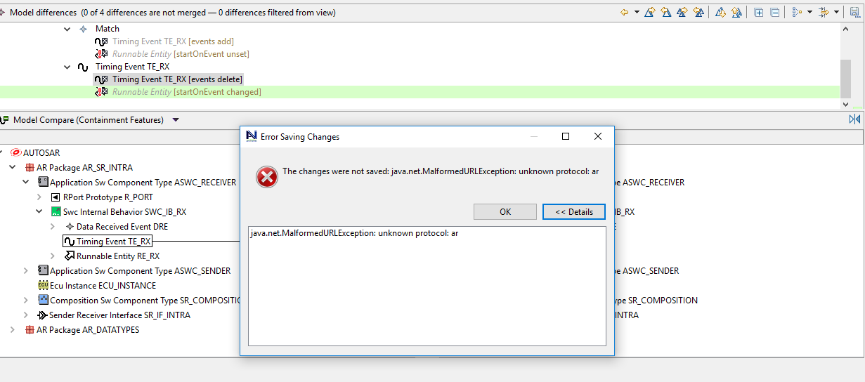

I am trying to compare and merge two resources using EMF compare and Merge.I am getting InvocationTargetException when commiting the merge transaction so please give me solution. please find code and error screen shot.

Below line of code throwing the exception
PlatformUI.getWorkbench().getProgressService().run(true, true, new IRunnableWithProgress() {
public void run(IProgressMonitor monitor) throws InvocationTargetException, InterruptedException {
try {
saveChanges(monitor);
} catch (CoreException e) {
throw new InvocationTargetException(e);
  • Attachment: error.PNG

I am Sorry for posting in two places.Please find stack trace below
!ENTRY org.eclipse.emf.common 2 0 2018-11-20 15:36:41.749
!MESSAGE An exception was ignored during command execution
!STACK 0
org.eclipse.emf.common.util.WrappedException: An exception was ignored during command execution

Caused by: org.eclipse.emf.common.util.WrappedException: java.lang.NumberFormatException: For input string: "AR_SR_INTRA"
at org.eclipse.emf.ecore.resource.impl.ResourceImpl.getEObjectForURIFragmentRootSegment(ResourceImpl.java:717)
at org.eclipse.emf.ecore.resource.impl.ResourceImpl.getEObject(ResourceImpl.java:763)
at org.eclipse.emf.ecore.resource.impl.ResourceImpl.getEObject(ResourceImpl.java:742)
at org.eclipse.emf.ecore.resource.impl.ResourceSetImpl.getEObject(ResourceSetImpl.java:223)
at org.eclipse.sphinx.emf.ecore.proxymanagement.ProxyResolutionBehavior.eResolveProxyInResourceSet(ProxyResolutionBehavior.java:63)
at org.eclipse.sphinx.emf.ecore.proxymanagement.ProxyResolutionBehavior.eResolveProxy(ProxyResolutionBehavior.java:47)
at org.eclipse.sphinx.emf.ecore.ExtendedMinimalEObjectImpl.eResolveProxy(ExtendedMinimalEObjectImpl.java:28)
at autosar40.swcomponent.swcinternalbehavior.rteevents.impl.RTEEventImpl.getStartOnEvent(RTEEventImpl.java:298)
at autosar40.swcomponent.swcinternalbehavior.rteevents.impl.RTEEventImpl.eGet(RTEEventImpl.java:441)
at autosar40.swcomponent.swcinternalbehavior.rteevents.impl.TimingEventImpl.eGet(TimingEventImpl.java:245)
at org.eclipse.emf.ecore.impl.BasicEObjectImpl.eGet(BasicEObjectImpl.java:1011)
at org.eclipse.emf.ecore.impl.BasicEObjectImpl.eGet(BasicEObjectImpl.java:1003)
at org.eclipse.emf.ecore.impl.BasicEObjectImpl.eGet(BasicEObjectImpl.java:998)
at org.eclipse.emf.ecore.change.impl.FeatureChangeImpl.preApply(FeatureChangeImpl.java:692)
at org.eclipse.emf.ecore.change.impl.ChangeDescriptionImpl.preApply(ChangeDescriptionImpl.java:803)
at org.eclipse.emf.ecore.change.impl.ChangeDescriptionImpl.applyAndReverse(ChangeDescriptionImpl.java:324)
at org.eclipse.emf.edit.command.ChangeCommand.undo(ChangeCommand.java:163)
at org.eclipse.emf.common.command.BasicCommandStack.undo(BasicCommandStack.java:143)
... 84 more
Caused by: java.lang.NumberFormatException: For input string: "AR_SR_INTRA"
at java.lang.NumberFormatException.forInputString(Unknown Source)
at java.lang.Integer.parseInt(Unknown Source)
at org.eclipse.emf.ecore.resource.impl.ResourceImpl.getEObjectForURIFragmentRootSegment(ResourceImpl.java:713)
Re: EMF Compare and Merge [message #1798609 is a reply to message #1798606] Wed, 21 November 2018 01:08 Go to previous messageGo to next message
This stack trace suggests that a number of additional software components are involved. I.e., Autosar models, based on Sphinx. It also suggests that your instance model contains a bad proxy URI fragment, or at least one that can't be handled by a non-specialized resource implementation. Perhaps Sphinx/Autosar has a specialized resource implementation that should be used but isn't being used. The fragment starts with a "/" and what follows is not a number, so definitely either the fragment is incorrect or the wrong resource implementation is being used to load the instance. But only you can solve that problem and you have more than enough information to set a break point and find out what's going wrong.
Re: EMF Compare and Merge [message #1798732 is a reply to message #1798609] Fri, 23 November 2018 07:01 Go to previous messageGo to next message
Hi Ed Merks,
Actually i am getting that Error for only imported arxml file which is generated by artop model, if I export model which is generated by my work space it is working fine. So can I get any example how to convert imported arxml file to AUTOSAR model in work-space.
Re: EMF Compare and Merge [message #1798734 is a reply to message #1798732] Fri, 23 November 2018 07:08 Go to previous messageGo to next message
Use the Sample Reflective Ecore Editor to detect where the bug is.
If your model can be successfully loaded and validated, then the producer is ok and the consumer is bad. Else the producer/installation is bad and you are wasting time attempting to debug consumers.
Ed Willink
Re: EMF Compare and Merge [message #1798760 is a reply to message #1798734] Fri, 23 November 2018 11:14 Go to previous message
This is the EMF forum, not the Artop forum and not AUTOSAR fourm. You need to consult with the people who are providing these specific technologies.
