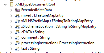

Iam thinking that these elements doesnt exist in my model. I found that they exist in org.eclipse.emf.ecore/model/XMLType.ecore.

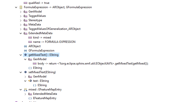

Iam creating Sirius project by taking artop model as a base for my project.I have created all the elements(like Composition ,ARPackage, Application SWcomponent Type etc.,)exists in artop model as diagramatic representation in Sirius.
I got stuck in creation of Text,CDATA,Comment and ProcessInstruction .How to create these elements in sirius .How to represent these elements in sirius.

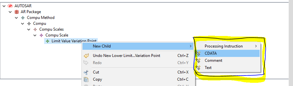

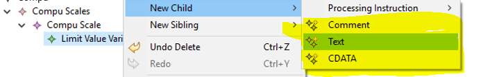

2)In second attachment I have created text and comment under Limit Value variation Point. Limit Value variation Point is having feature as mixed where it will store Text,Comment,CDATA but how to show these elements in eclipse sirius.

Iam having a class which is having a feature mixed.This feature mixed will hold (text,CDATA,Comment).
mixed[ecore.xml.type: text]
mixed[ecore.xml.type: CDATA]
mixed[ecore.xml.type: Comment]
I have created the sirius representation for the class but I dont know how to create sirius representation for (text,CDATA,Comment) so that (text,CDATA,comment) needs to display as a property so that we need to allow user to give values for mixed.
