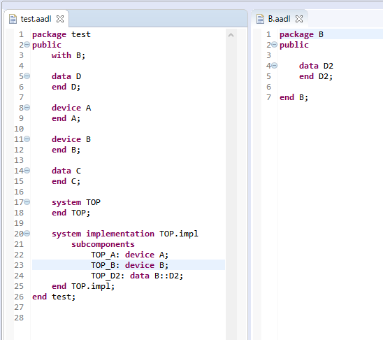

I'm running into trouble modifying files that are imported from the file I originally run my code from in the editor. To make this concrete, I've attached an image of two test file that I'm using to illustrate the current problem. In it, there are two files "test.aadl" and "B.aadl", which contain packages (a package is a top level eobject defined in the xtext grammar for AADL) "test" and "B" respectively.

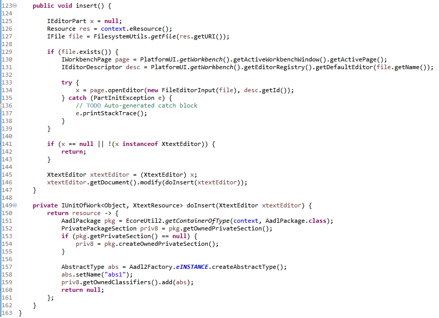

I want to modify package test and, conditionally, I might want to modify package B when my code detects that something should be added to B. To accomplish this I'm using the following code snippet
index.php/fa/34331/0/
In this code, I have a contextual element (context, it is referenced in line 126 to get the resource) that I used to figure out where something needs to be added to the model. I use it to get the resource associated with it, open the file associated with the resource in the editor (line 134), and then use the getDocument().modify method of the editor to create a ReconcilingUnitOfWork object to do the actual modification within. The modification itself is shown in the method lines 149-163.
The problem? When I run this code, it is launched from an button press event in the editor that initially has "test.aadl" open, but not "B.aadl". If I it needs to modify "test.aadl" the code will launch an editor for "test.aadl" (it is already open) and modify it. If the code determines it must modify "B.aadl", it should open it (it is *not* already open) and then from the newly created editor, create a ReconcilingUnitOfWork inside which it can do that change.
The problem is this code opens imported files, but does not modify them. Inspection through debugging confirms the model for "B.aadl" is updated in memory, but the changes are not reconciled to the concrete syntax.

following your description it is really hard to understand "what" you are actually changing and what is not working.
i assume modify only changes resources you call it on. => you have to call modify twice.
did you consider to have a look and use the change serializer api instead (no documentation, no tutorial, sorry)
as a starting point what to do you may have a look for org.eclipse.xtext.ui.editor.model.edit.BatchModification
