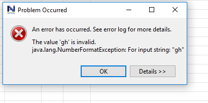

Hi all,
In sirius table if we enter data of different data type i.e., instead of number if we enter string one dialogue box with title "Problem occurred" will display and unable to edit that cell.
If we want to edit we need to reopen that table.

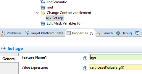

[2] Or can we check for the data type when we enter the value expression arg() in label edit. But for that how can we give condition because in set while entering the arg() we should give condition.
I tried calling setValue(arg()) in value expression which is not working!!

So I would agree with your second proposition that is using a service to check the value and to manage wrong matching with the requested value type.
Peering your Value Interpreted Expression, it seems that you miswrote the arg0 argument. You used opening and closing parenthesis instead of 0 digit.

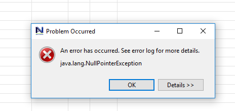

But if I change also it is not working
index.php/fa/34328/0/
I am getting NPE.. It is not considering that service method service:setValue(arg0) If I give service method without passing argument it will work.

I tried using service method it is working for integer value if I set value expression service:setValue(arg0)
But if I enter alphabetical value we are getting java.lang.IllegalArgumentException
Below is the stack trace of my code.
!ENTRY org.eclipse.ui 4 0 2018-12-20 16:33:56.629
!MESSAGE Unhandled event loop exception
!STACK 0
java.lang.IllegalArgumentException: The value 'hn' is invalid. java.lang.NumberFormatException: For input string: "hn"

and after we can not edit that cell. Can anyone help me on how I can enable that cell after getting that error.
