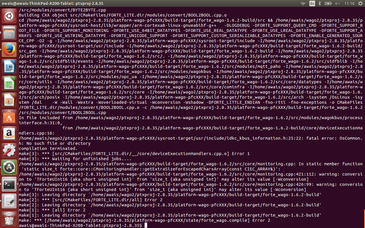

Re: Forte not compiling for Wago PFC200 [message #1798499 is a reply to message #1798374] Mon, 19 November 2018 17:18 Go to previous messageGo to next message
Hello Alois,
I git pulled on forte-incubation_1.10.0.RC2. Attached is the screenshot of the compilation error that I get.
Re: Forte not compiling for Wago PFC200 [message #1798502 is a reply to message #1798499] Mon, 19 November 2018 21:55 Go to previous messageGo to next message
I kinda made that work by modifying #include <OsCommon.h> to #include <OsLinux/OsComman.h> in ldkc_kbus_information.h and ldkc_kbus_register_communication.h files. I hope it works fine and doesn't break anything at the runtime.

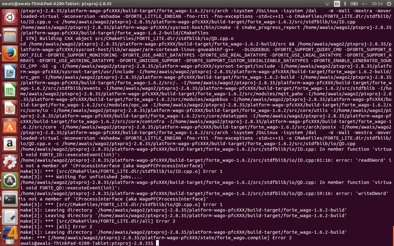

Re: Forte not compiling for Wago PFC200 [message #1798525 is a reply to message #1798502] Tue, 20 November 2018 02:56 Go to previous messageGo to next message
One more problem that I face is that when I include -DFORTE_IO in forte_wago.make file so that I can work with IOs, it does not compile as well. Attached is the compilation error screenshot.
Re: Forte not compiling for Wago PFC200 [message #1798537 is a reply to message #1798525] Tue, 20 November 2018 04:28 Go to previous messageGo to next message
Sorry for the dumb question but have you followed our guidelines on building for Wago? What else have you modified in our files? ID and QD should not be compiled into the system for Wago.
What modules have you activated? Could it be that you have conflicting IO modules activated?
Re: Forte not compiling for Wago PFC200 [message #1798540 is a reply to message #1798537] Tue, 20 November 2018 04:38 Go to previous messageGo to next message
Yes I have followed the instructions to build for wago. Apart from default flags given in forte_wago.make provided in build-support folder, I have switched on FORTE_IO, FORTE_MODULE_IEC61131, FORTE_MODULE_UTILS flags.
I have changed any files apart from the files mentioned in last message.
Re: Forte not compiling for Wago PFC200 [message #1798543 is a reply to message #1798540] Tue, 20 November 2018 05:14 Go to previous messageGo to next message
Ah please disable the IO module.
Re: Forte not compiling for Wago PFC200 [message #1798603 is a reply to message #1798543] Tue, 20 November 2018 18:14 Go to previous message
Thanks, Alois. It works now.
