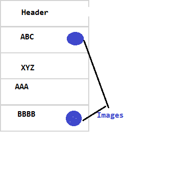

How to set particular cell inside Image with Text with attached file in blue color round is my image.

I hope I understand your question correctly. You want to show an image inside a cell, not a cell inside an image, right?
Please have a look at the CellPainterDecorator_Example that should include several examples how this can be done.

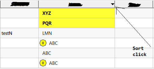

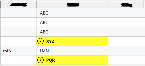

Thanks it is working but some other issue coming when I try to column sort but image not sort with text so please help me how to fix it.

Previously show image with text and then click to sort on column header but that time not show correct result now i have added attachment files and code.
columnxyz.setCellPainter(new CellPainterDecorator(new TextPainter(), CellEdgeEnum.LEFT, 9, new ImagePainter() {
            protected Image getImage(ILayerCell cell, IConfigRegistry configRegistry) {
                return imagepath;
Please help me.
