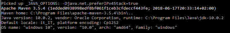

this is the version of Java that I have on my machine
index.php/fa/34295/0/
and this is the version of maven on my machine
index.php/fa/34296/0/
I think that on my installation is missing something, but honestly for the moment I don't know what.

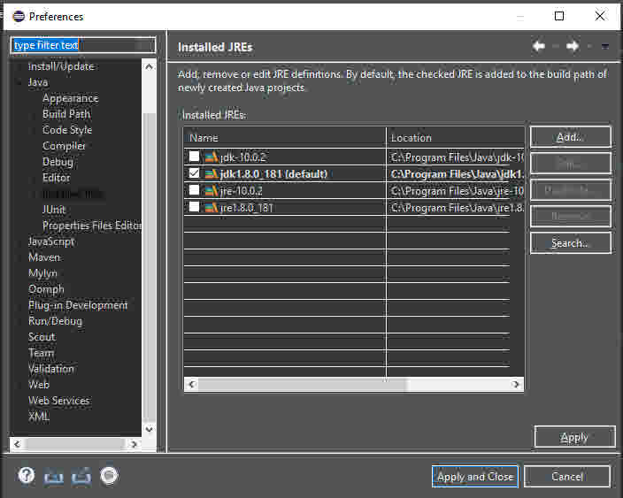

Re: Error on the start of the simple project [message #1797965 is a reply to message #1797963] Fri, 09 November 2018 04:41 Go to previous messageGo to next message
my Eclipse Photon is set to use JDK 1.8
index.php/fa/34297/0/
This is enough or not?
Re: Error on the start of the simple project [message #1797972 is a reply to message #1797965] Fri, 09 November 2018 06:04 Go to previous messageGo to next message
What is in your project pom.xml?
For me its:
<properties>
    <jdk.source.version>1.8</jdk.source.version>
    <org.eclipse.scout.rt.version>8.0.0.021_Simrel_2018_09</org.eclipse.scout.rt.version>
  </properties>
Maybe thats a point to step into?
Re: Error on the start of the simple project [message #1797973 is a reply to message #1797972] Fri, 09 November 2018 06:24 Go to previous messageGo to next message
Thanks for your hint, in my project pom.xml this value is 10 and after I chenged to 1.8 as yours everything start to work.
Many thanks
