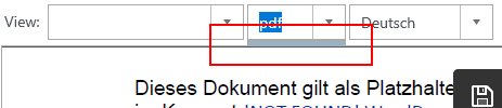

In my RAP application I have a few combos and a browser below which shows a pdf file:
index.php/fa/34269/0/
The problem, if the combo opens the dropdown it vanishes behind the pdf.
Any known workaround for this? Doing some research I found out that setting the "z-index:-1;" would probably help, but I didn't find a way to add it to the browser widget.

Hi Flavio,
we have many RAP applications with this same problem still unsolved, see here
https://www.eclipse.org/forums/index.php?t=msg&th=629619&goto=1224742&#msg_1224742
We had to surrender the fact that, if using IE or Edge, when showing a PDF any other drop-down, dialog or similar are being hidden by the PDF layer.
In particular, if a dialog is shown (either an application specific one or an automatic one that comes from an error) and its completely under the PDF, then the UI experience is terrible, since the user sees a freezed UI (grey-inactive all around the PDF), but has no clue how to get out of this (well, generally hitting the Return key closes the underlying dialog).
Up to now we changed the layout and tried to intercept every dialog and replace them with a message in a component that shows in a side area (with respect to the PDF area), or reducing the PDF area trying to avoid the overlapping.
If you find a better way, please update us in this thread!

Bets would be to use a non-native PDF viewer like PDF.js.
PDF.js draws into a normal HTML5 canvas and therefore conforms to Z-Ordering.
