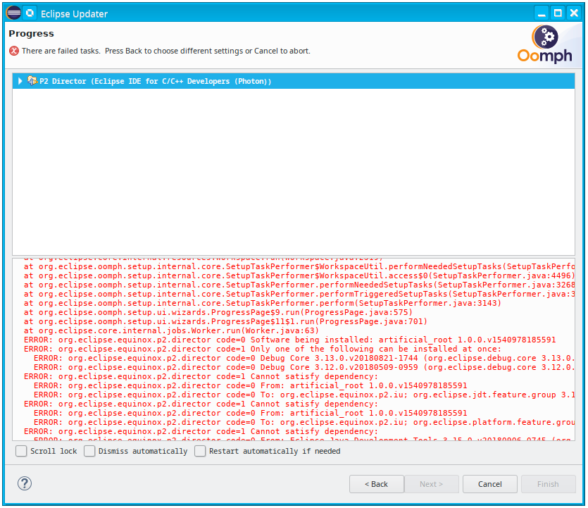

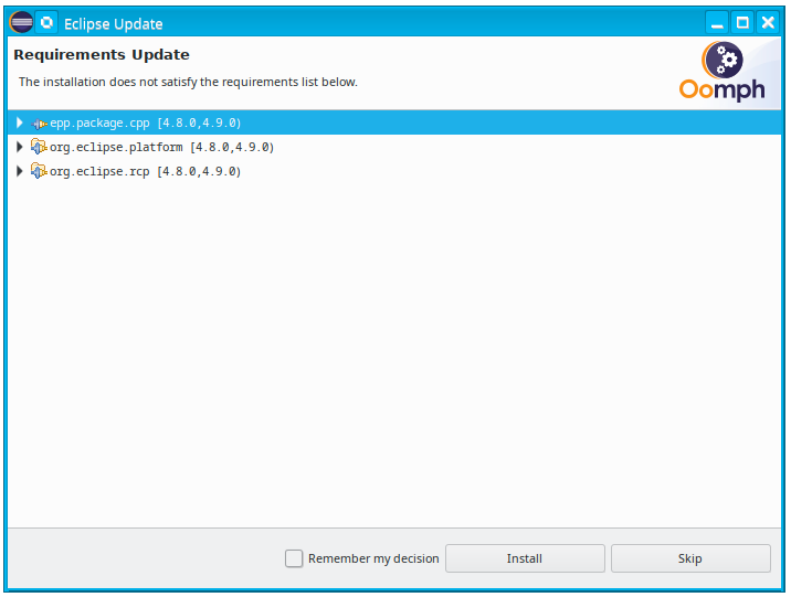

After updating Eclipse Photon to 2018-09, the startup shows a screen for requirements update (attached: Req.png).
When accepting the update, Oomph shows an error (Fail.png).
Any pointers to correct the situation?

Yes, unfortunately the Photon installation created with the Photon installer really wants to be a Photon installation so if you manually update it, it will complain that it's no longer Photon with this rather user-unfriendly overly-technical dialog. You could tell it to "Skip" and to "Remember my decision" to keep your manual updates as is. If you let it "perform" it will try to downgrade your installation back to Photon, which is unlikely to be what you want (and apparently fails in your case).
At EclipseCon I discussed this with other folks at the Planning Council and I think it will be better if the product catalog is generated so that the upper bounds are removed from the requirements such that this dialog will not appear when you manually update.
