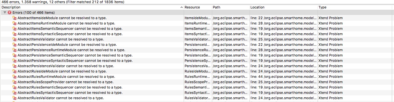

I've added a screenshot of the errors. They seems to be all Xtend based.

Looks indeed as if steps 8+9 have not been successfully executed.
Step 8 launches a longer running background task. Please check wether this completed successfully or if it logged any errors (click on the little rotating blue/yellow arrows in the IDE footer (with the tooltip "Eclipse Updater") to see the progress in detai).
Re: Newbee - .gitignore is broken [message #1797484 is a reply to message #1797456] Wed, 31 October 2018 10:21 Go to previous message
I've found the problem: You have to set Java Version twice. Maybe you could update Step 3 and 5 with the hint "Check, that Java Version is 1.8". Probably you have to change only the Version in Step 5, but I didn't check this.
