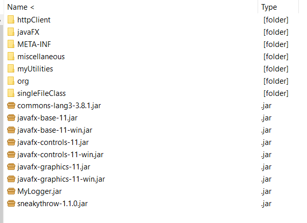

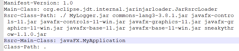

- a Runnable JAR is working !!! it containes the javaFX jars
index.php/fa/34195/0/
index.php/fa/34197/0/

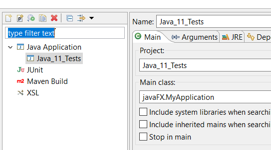

- I get the message in the IDE when I use the regular run configuration
index.php/fa/34196/0/

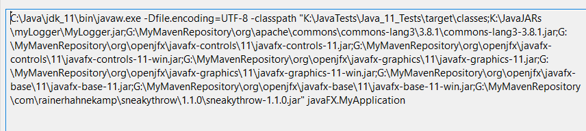

Perhaps s.t. is not good in that launch configuration.
Luckily, the launch configuration dialog now has a button "Show Command Line" that shows you, how Eclipse is invoking your program. From there it should be easy to figure what is missing.
Re: Eclipse 2018-09 and JavaFX 11 adventure [message #1797470 is a reply to message #1797436] Wed, 31 October 2018 06:33 Go to previous message

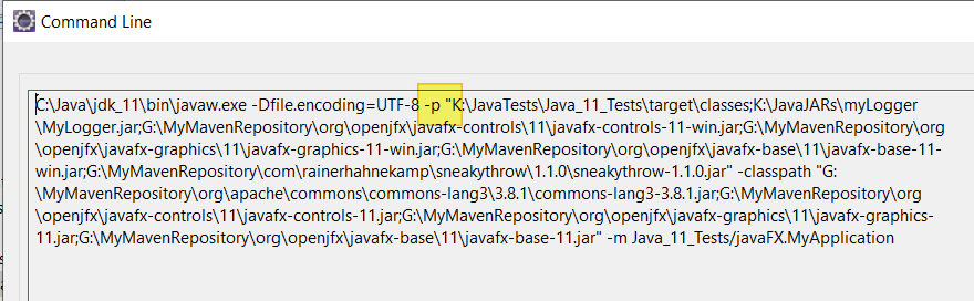

index.php/fa/34208/0/index.php/fa/34207/0/Thanks for the response.
This is the "Show Command Line" output.
index.php/fa/34206/0/
The FX stuff is there....
But there is new development.

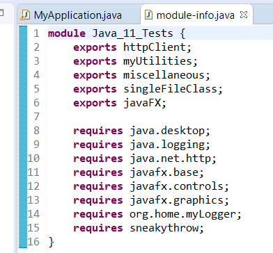

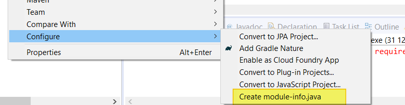

When I generate file module-info.java
I have
It is working !!!!
Also the -p is added (--module-path)
index.php/fa/34209/0/
Thank you !!!
