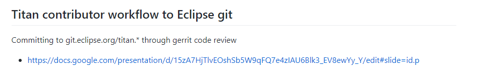

However we have put together a workflow for eclipse git contributors too:
index.php/fa/35202/0/
https://docs.google.com/presentation/d/15zA7HjTlvEOshSb5W9qFQ7e4zIAU6Blk3_EV8ewYy_Y/edit#slide=id.p
Please try to fight yourself through it ; if any problems let me know; else of course we can proxy you, but I'd prefer to have the procedure followed.
