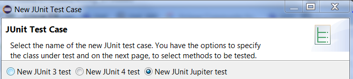

Re: How do I create a JUnit5 Test Suite in Eclipse? [message #1796906 is a reply to message #1796880] Mon, 22 October 2018 03:32 Go to previous messageGo to next message
Doesn't the wizard look like this?
index.php/fa/34126/0/
I assume that Jupiter == 5
[Updated on: Mon, 22 October 2018 03:33] by Moderator
Re: How do I create a JUnit5 Test Suite in Eclipse? [message #1796926 is a reply to message #1796906] Mon, 22 October 2018 08:54 Go to previous messageGo to next message
Yes, that's what I get for a test case but the wizard I see when I try to create a test SUITE only has options for JUnit 3 and JUnit 4.
